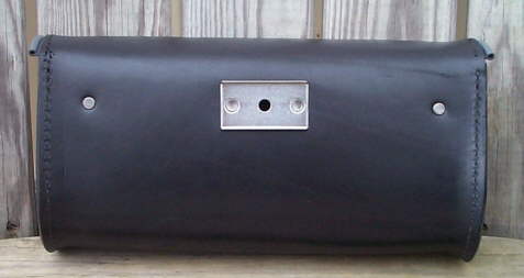

Thanks, Chris! The Raod King bag has a leather tab sewn on the back. There is a hole in it that lines up with the lower console screw. I also use velcro on the top and bottom as a secondary mount. Tim

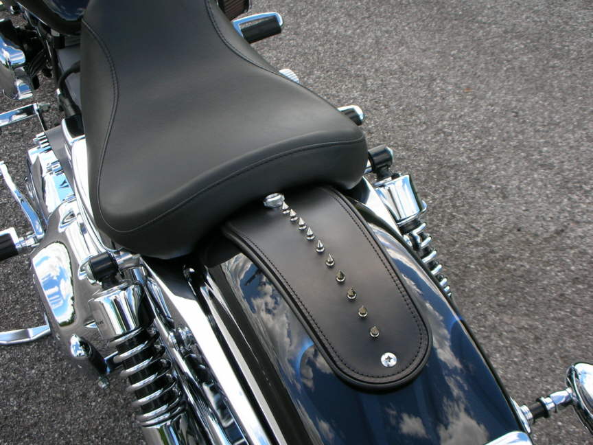

Had a request for a spiked fender bib, for a customer's Harley Dyna Street Bob. He emailed this photo of the installed fender bib. ....Guess he won't be packing any riders around on this one! Tim

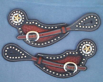

Hey Duke, that part of the the spur strap is two layers. There is an inside cover over the spur button. The concho mounts on the outside/ the inner layer goes on the spur button. Tim

Made this pair of spur straps recently. Buckaroo style with Texas Ranger star conchos, & basket stamped inner portion. Tim

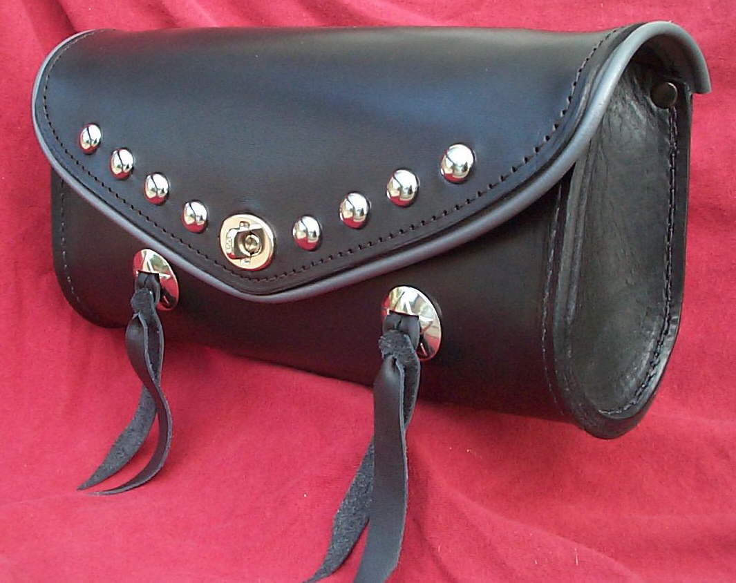

Finished this windshield bag today....going on an HD Heritage Softail. Your basic black and chrome...ya I know,.. kind of boring, but that's what the customers want. Thanks for veiwing! TW

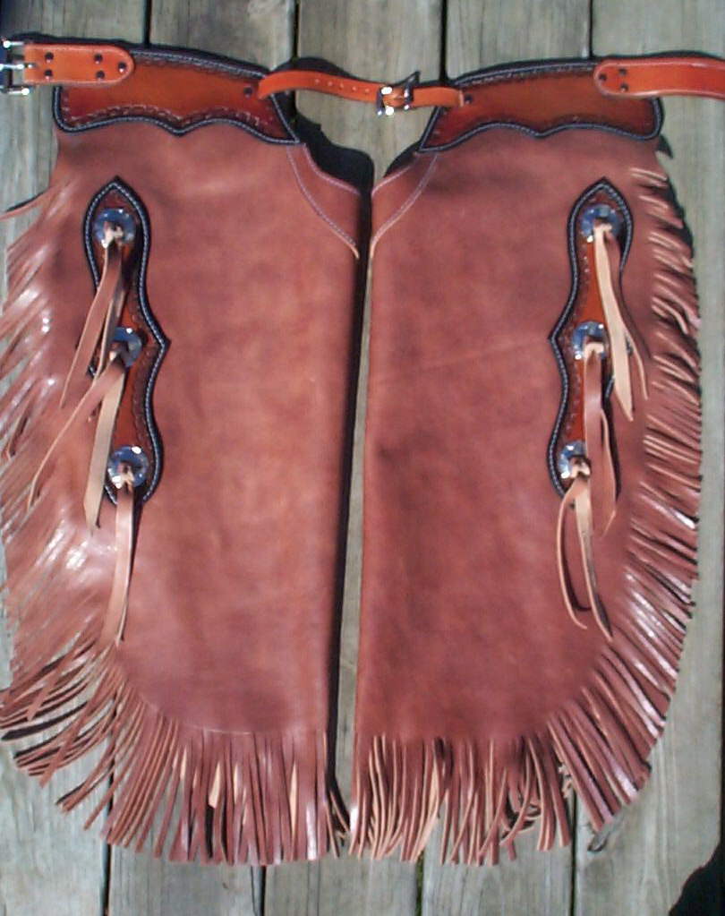

Thought I would make myself some chinks,... nothing fancy, just basic riding/work chinks. Actually my first pair. My usual stuff is cycle related, but a departure from the usual is needed once in a while. Tim
