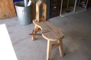

Thanks for posting the pictures Johanna and Clay. Does anyone have a picture of the stitching horse that was in the competition room? Thanks, Marlon -

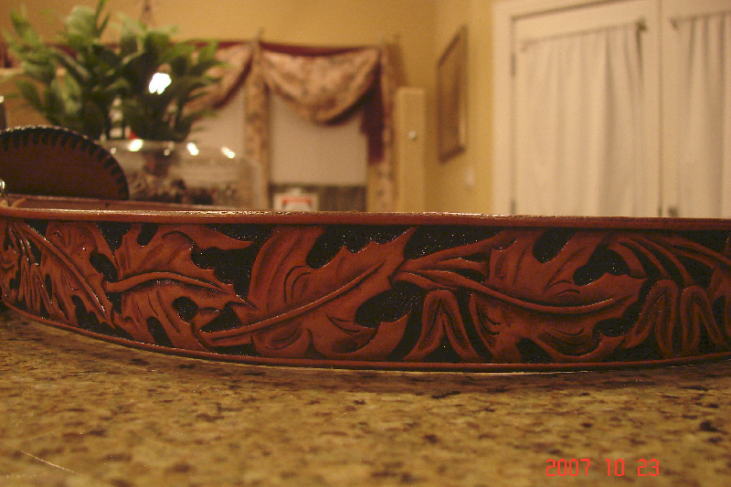

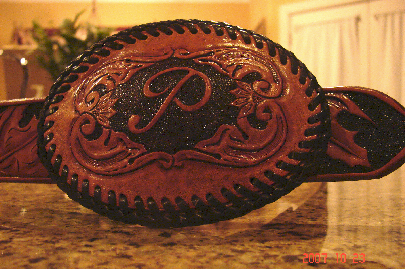

Thanks for the comments guys. I try to improve on every project, and I think this one is my best yet. I almost don't want to give it to him. Marlon

I made this belt for as a freebee for my cousin. How much would you charge the general public for something like this? Criticism is always welcome.

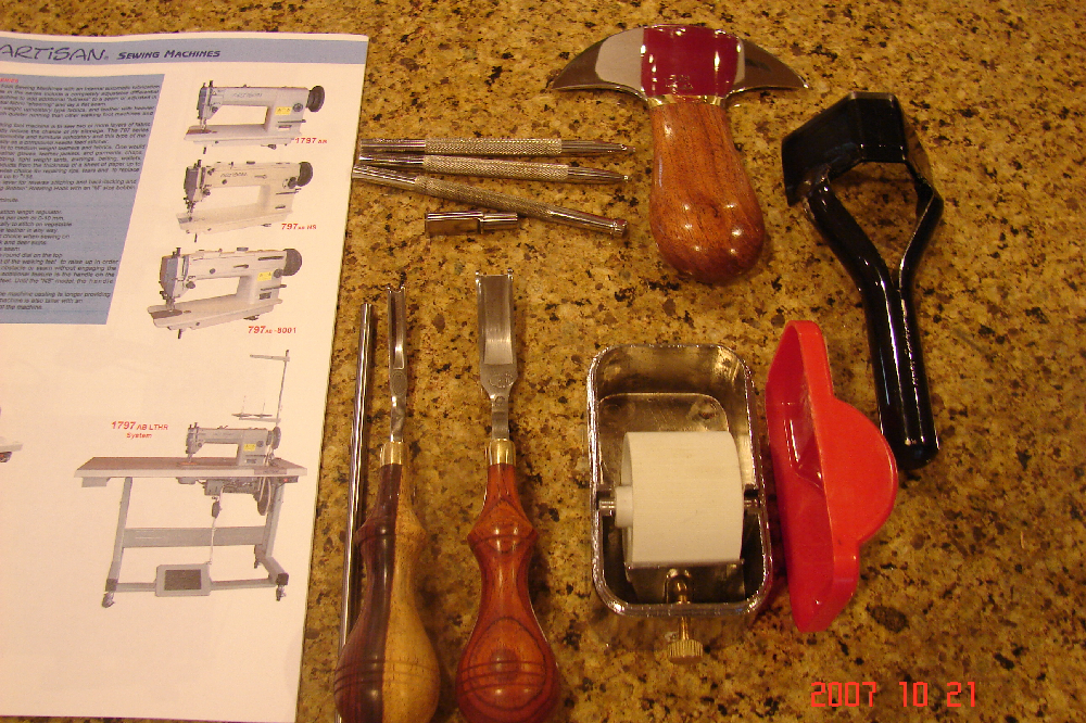

Here's a photo of the things I purchased at the show. I didn't know if people like to see things others buy, but I do, so hence the reason for the topic. Enjoy. 1. Bottom left - Artisan, 1797 AB LTHR Sewing System 2. Top Middle - Some Barry King, Backgrounders, and Beader Blade. 3. Top Middle - Danny Marlin, Head Knife. 4. Far Right - Tandy, Strap End Cutter. 5. Bottom Middle - Ron's Tools, #4 Edger w/ sharpening rod, and also #6 French edger. 6. Bottom Right - Some company from Austrailia, Edge dyer
