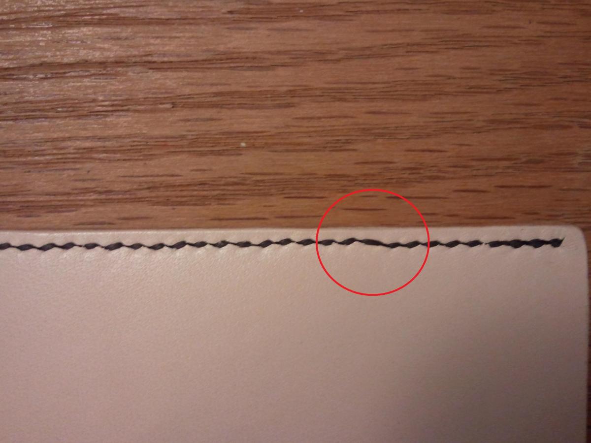

Hey Jim, thanks for the reply Sorry I was not clear about this, but I am not using a sewing machine....I am hand stitching....... I was experimenting last nite and discovered that when you are passing the needle/thread through the hole just above the top of the card pocket, I just have to be extra careful with which direction I'm pulling the thread to get it to seat properly and lay like the rest of them..... In other words, I normally pull the left thread up and the right thread down......I've found that if I exaggerate this, the thread seats normally.... Thanks again!!! This is definitely a learning process haha -

Hey friends, I was wondering if anybody has any suggestions to correct this......please refer to the photos....I made a stitch straddle a card slot and it completely ruined the line of stitching....I didn't change anything about the thread/needle priority or tension, I kept everything the same.... I wonder if this has anything to do with it.......instead of spacing the stitch where the top edge of the card slot would be in the middle of the stitch that is straddling it, I put the hole at the top edge....
