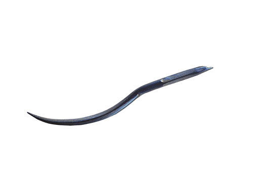

Hi all, Does anybody have any suggestions as far as what to used to sharpen or how to sharpen a curved diamond awl (see attached photo) Thank you in advance for your help!

Good idea Tree, thank you I took some time sharpening the blade and that did the trick--didn't realize how dull my awl was getting lol...thanks again!!! Thanks everybody for sharing!!! -
