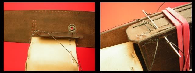

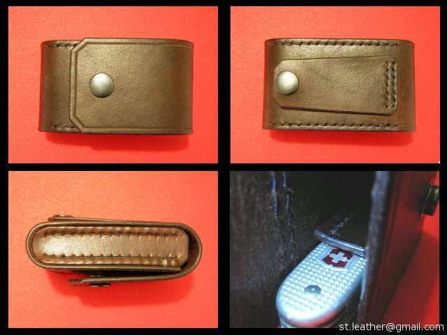

Hi friends, I saw this pouch stitched by Singteck on the BritishBlades forum, and I know it's saddle stitched, but I just can't get my head wrapped around how this thing is secured vertically within the pouch. Can anyone shed some light? I know that Singteck punched holes in the back of the leather pouch and in the actual divider itself...I just can't visualize how the stiching would start/finish. Thanks for any help that you could offer!!! =)
Hey Math, Refer to The Art of Making Leather Cases, Volume 1 by Al Stohlman, page 26....I think you will find the technique you are looking for there. It's basically a box stitch following a curved edge (I think)... have a look at this from the Stohlman Book--hope it helps!!!
