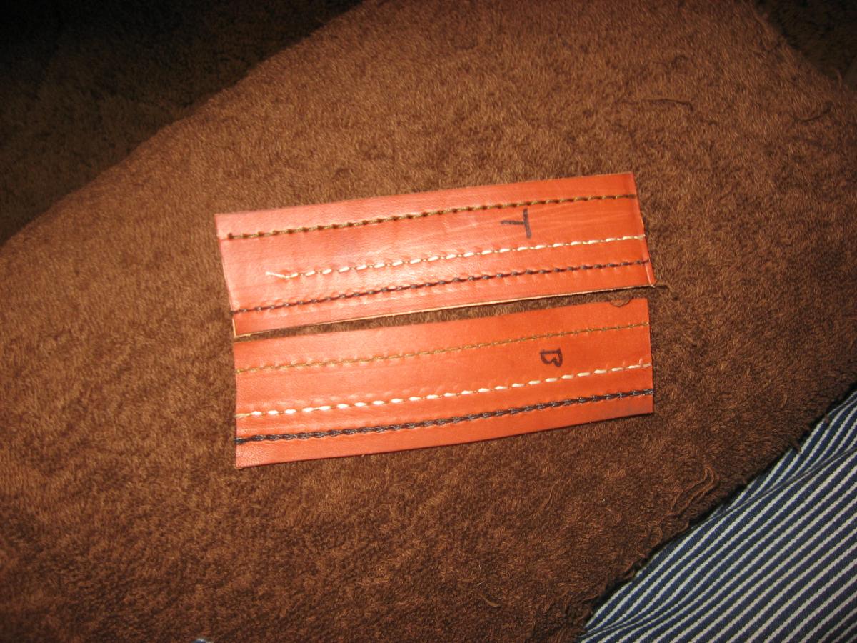

2 layers of 3/4 oz. the white row is the Randall. I did the black with the Puritan just for kicks. The green or top row is with the 153k102 singer needle feed. all with 138 thread. could fine tune the Randall and singer for a little better look as I changed the Randall from 207 and the singer from 92 but didn't mess with the settings. -

I have 3 awl and needle machines. A landis 12 sole stitcher, a Puritan chain stitcher, and a Randall. the Randall can be set up to sew thin leather and makes a stitch 2nd to none. the problem you will have is concealing the knot from that size thread in that thickness of leather. It can be done but It takes some fine tuning. The Puritan will also sew thin but most people don't like the chain stitch on the back side. I personally kind of like the way it looks on some items, it is a very consistent tight stitch. -
