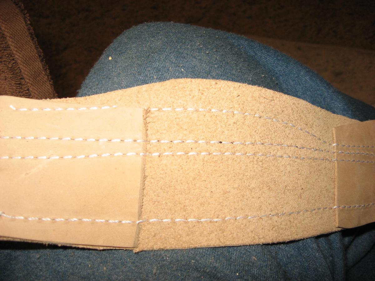

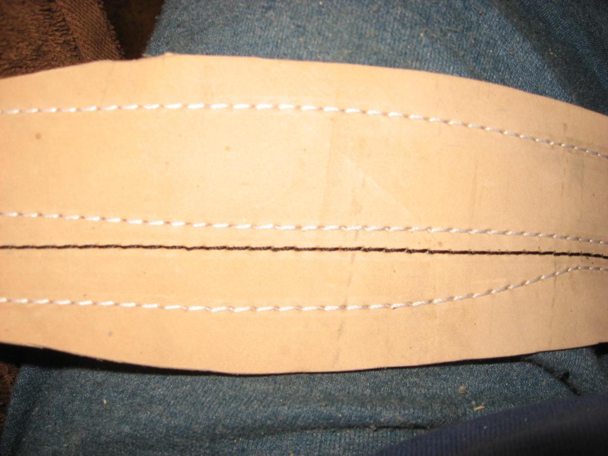

Sewing Between 1 And 2 Layers Of 5 Oz - Cowboy 3200 Best Way?
pcox replied to BDAZ's topic in Sewing Leather
As far as the center foot height if you are talking about the slot on the back it is in the center of the slot. The pictures show the knot much worse than looking at them for real. I just put the black in to see the white better no white on top but 2 or3 black dots on the single thickness back -
After reading your post I went to my 3200. 5 oz. natural strap, #23 needle, 207 bonded nylon thread top and bottom. Bobbin tension screw all the way tight, now here is what made it work, top thread thru only 1 hole on spool pin, top tension spring taken off a domestic sewing machine 6 coils of .040 wire, top nut 1/2 way on, bottom tension flush with stud. -
