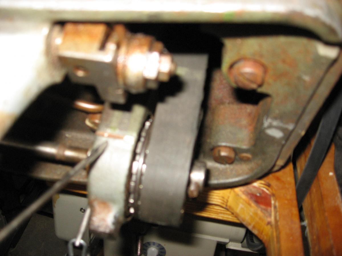

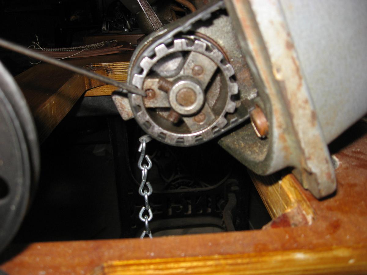

I think your machine has a clutch. 1 st pic shows 3 slotted screws. 2 nd pic shows timing mark on pulley. 3 rd shows mark on casting. Marks in pics 2 & 3 should line up when thread take up is at it's highest point. The screws in pic 1 have a second screw, a spring, and a ball behind them which drop into 3 dimples in the pulley shell this is the clutch connection. The 3 dimples are not 120* apart so they can only index in 1 position.

You said you have a manual, read about reengagement of safety clutch It is inside the belt sprocket on the right end of the bottom shaft.
Sounds like you safety clutch is releasing when you change stitch length.
