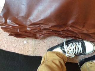

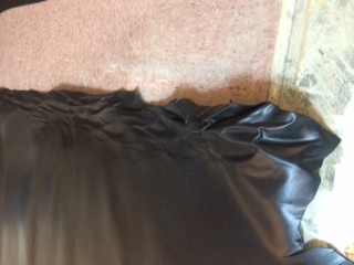

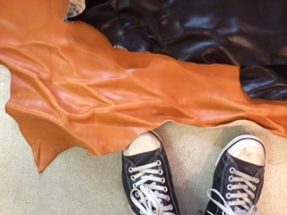

Hey everyone! Sorry for the delay. As you can imagine I was very busy fixing my production schedule because of this error. The tannery did the following to correct the error: Gave a 15% credit for each damaged hide (I needed the leather, so I refused to send it back) Paying for shipping to have the wrong weight leather sent back as well as a credit for the hides Free shipping on my next order to correct the leather that was a wrong weight That was what I was hoping was going to happen. I do feel made whole. I appreciate the comments and help throughout this post. It gave me a bit of courage to take on a powerhouse of a tannery. I feel I was more than taken care of considering the circumstances.
Hey all, Today I received a $6,600 leather order from... well, let's nickname them Franks Tannery. Their leather is great, and I don't want to scar the name. Franks sent me 30 hides of which 9 of them were the wrong weight. Also, eight of these hides were damaged (about 1/4 of them) from shipping. They were smashed along one side. Franks has messed up my order once before, but I had no course of action because I ordered over the phone. After that incident I started emailing to order my leather. I have the emails stating the exact specifications for the leather and Franks confirmation of the leather I ordered. What course of action can I take? Can I seek the loss from my profits? What about a discounted rate for the leather that needs to be shipped back and the new leather that is coming in? This mistake, if not fixed, will put me out of business. I would appreciate any and all help from the leather worker community on this matter so that my business can live another day and I can continue to do what I love for a living. I really don't want to go back to working for someone else. Maybe I'll go work at Franks to ensure this doesn't happen anymore? Thanks in advance, Stephen
