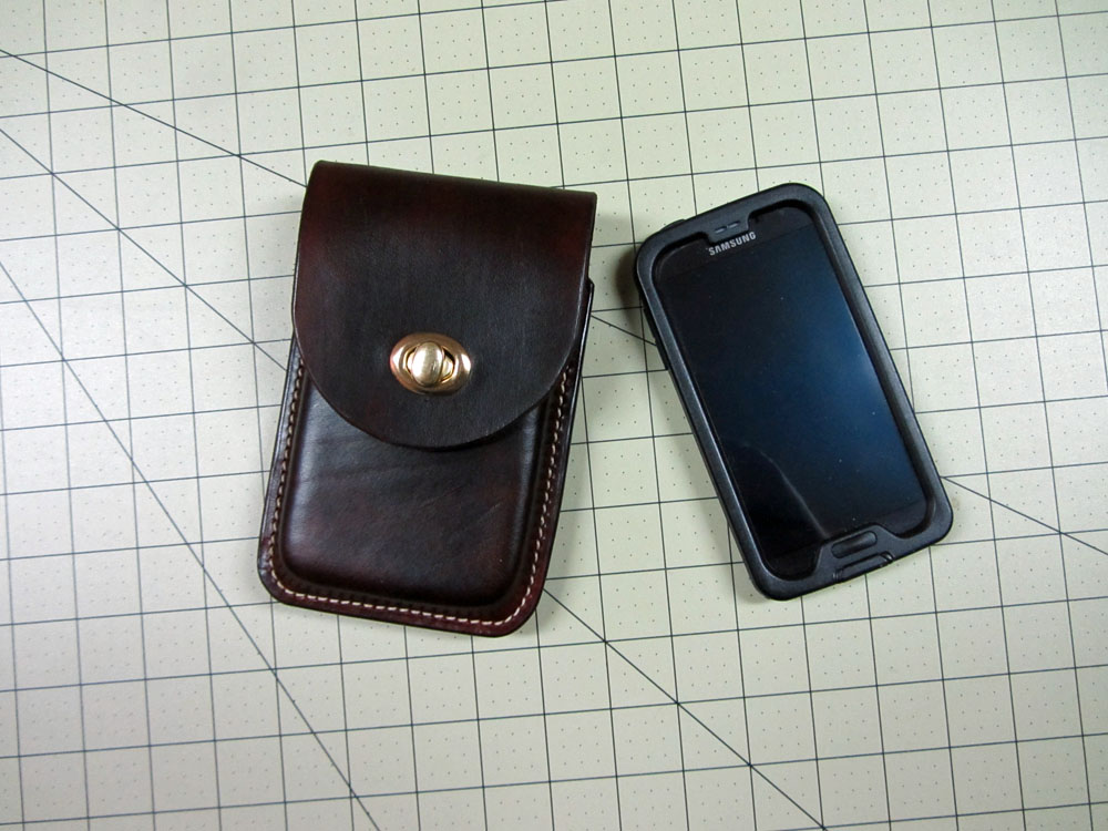

I recently bought a new phone after my old one died. Unfortunately, it is quite a bit larger than the old one and it doesn't fit into a shirt pocket either. So.... I picked through the scrap bin for some leather remnants and the belt case below is the result. It is primarily 7/8 oz veg tan with a recycled belt clip from Tandy. It seems to work okay, but next time I think I'll just get a smaller phone.
