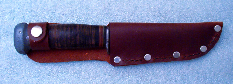

I have said before that I make and sell only simple items and sell them for very economic prices. I have no sewing machine and saddle stitch only. I have made myself a little retirement business doing this and it is very therapeutic for me. Here is a simple fixed blade knife sheath that has become very popular. The rivets squeeze the leather so tightly that the knife edge never reaches them. I have carried a razor sharp knife in a pouch like this for a long time without cutting through or losing the knife edge. At the present I only make one size of it. The knife in it is a Pal #25. I do know how to make fancy items, but I enjoy making the simple ones myself. -- Tex

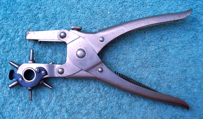

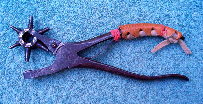

I like and have several older rotary punches. I have always wanted a sargent and Co. compound Parallel rotary punch. I have never cared for the standard design rotary. I recently picked one up that was virtually unused. When I got it I found out why, as it would not punch a clean hole. When in inspected it I found that the Punches were not striking the brass anvil square because for rivet tolerances in the compound action. This tool has a adjustable anvil (It is a brass screw) but would not lower enough to compensate for this problem. Therefore I screwed it up high enough and filed it On a angle to compensate. Now it works fine, infact it works with about 1/2 the hand pressure of a standard rotary. Here is a picture the Sargent and also of one of my other rotaries. It is a old Bulllock Mfg. Assoc. made in Springfield Mass. The Sargent was made in New Haven Conn. -- Tex
