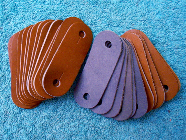

My favorite tool is a Lucrus clicker press. I have had one for several years and liked it so much that I bought another one. I found out that if taken care of you can't wear one out so I have the second one for sale. I look at the Lucris Clicker a money printing machine. What I mean by that is I just click parts and sell them. I can click 200 to 250 parts a hour easy and sell them for 30 to 60 cents. Do the math, even with the smallest of parts I can make $45 to $65 hour of work time. I don't do anything else that even comes close. It does take some time creating a market, but it is stable once created. Everything else that I do with leather is a hobby, but the little clicker is a part time business with very little effort. -- Tex -

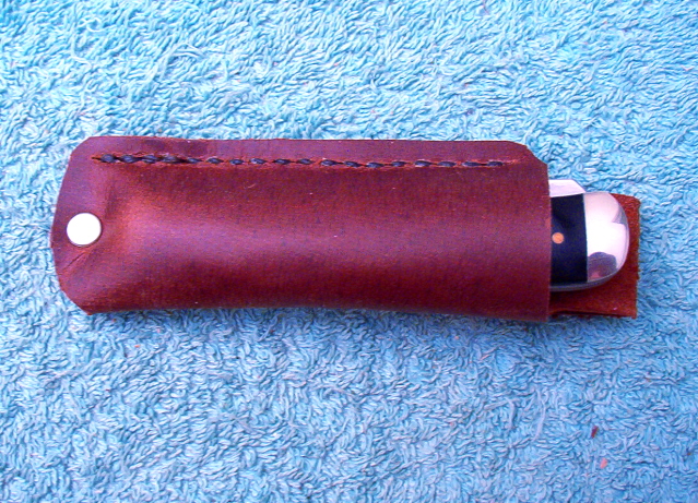

Recently I have split a bunch of 20 year old folding knife blanks. This was veg tan belly and I never thought about using the split off pieces for anything, but a lot of them came off at 5 or 6 oz weight. I had a idea that I think has merit. How about using the split off pieces for first time stitching classes such as boy scouts. I took a couple of the thinner ones that I saved and hand stitched them. I used no pricking awl or punching awl, but just marked the stitch line and used a stab awl to make the holes, then stitch with a single needle down and back and tied the end off. They looked pretty good and were very functional. (see Picture) This way someone new to the hobby would only need a stab awl one needle and some thread which could be supplied by the class instructor. This would be great for boys clubs and boy or girl scouts and etc. The stab awls could be made with a package of stab points and some hard wood tool handle blanks. The stab awl points about 50 cents and the file tool handle blanks about $1.00 and stitching needle about 40 cents. This would not only teach how to stitch but how to get by on a very little money. It has been my experience that local businesses will support such a effort. I know that the finished product does not look like much, but to a boy that does it himself it will give him great pride and just maybe make a new leather worker in the process. -- Tex
