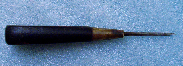

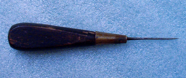

I have several stitching Awls, but this very old one is my favorite one. The tip has a slight bend that that I find makes it easy to use and it has a perfect diamond shape set at a good angle for me. It goes through the oil tan and chrome tanned leather that I use like butter. I know, it is ugly and was probably a cheaper one when bought, but it has made its way into my heart! -- Tex
