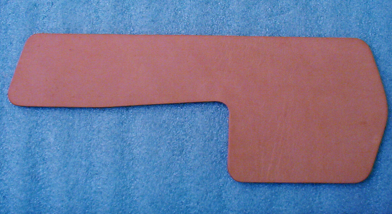

I just bought a refurbished American crank type splitter and it will be here this week. I have never used a splitter before, so I know that I have a learning curve. I have two very basic questions. 1) does the leather insert with the grain up or down? 2) I have a couple hundred of 3 sizes of veg tan folding knife blanks that are too thick and need to split. These blanks are about 16 years old, but are in good shape. The leather is very dry and stiff. Should I split then dry or should I try to condition them first. I have clicked a couple of them down one size and they cut clean on my Lucris clicker press. I have recently made a few knife sheathes with the thinner blanks and they worked fine. moistened the stitch line a little before stitching. -- Tex -- Here is a picture of one of the blanks.

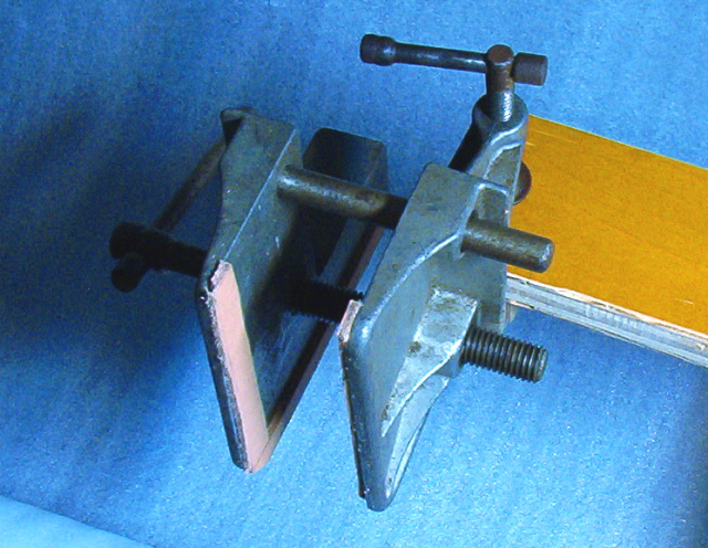

Update! I have glued some scrap veg tan leather strips to the vice to get a little clearance. Also I had a 2 dollar price tag on it to sell, which means that I only paid one dollar for it at the garage sale. The notches on the edge of the vice were there when I bought it. I took a picture of it flipped over to show how it can be used for a vertical clamp. I had not used it yet when I shot the first pictures, but I have now and it works great for knife sheathes. I still like to stitch without a clamp when I am watching TV, but it is slower. -- Tex
