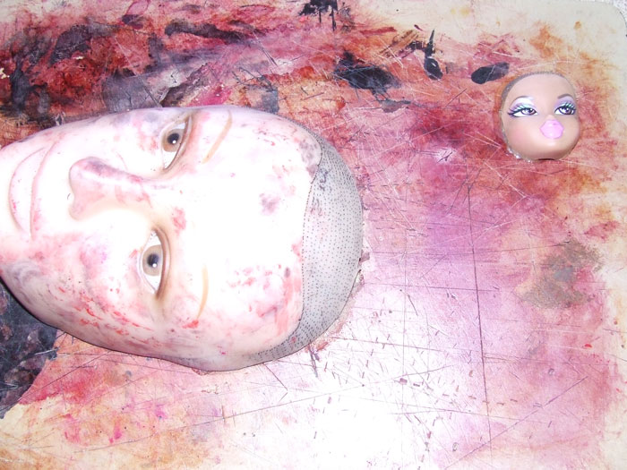

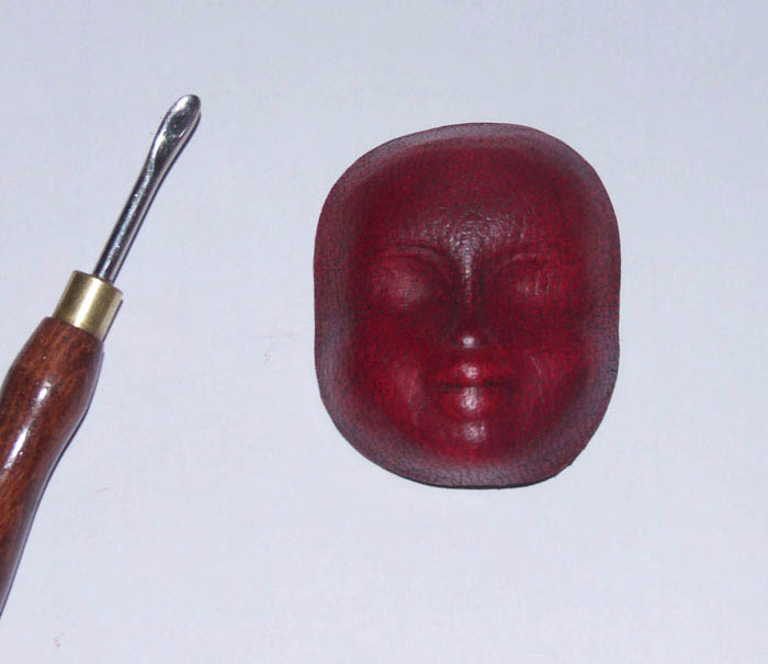

I decided to have a go at the dolls face that Jolieo asked questions about. I found an old Bratz doll and cut off her head and the cut the head in half and glued it to my 'head board'. I used 0.9mm leather, wet it, stretched it and went about molding it. I found that the dolls face didnt really have enough definition in the features for a good mold. If i was to do this again i would look for a dolls face that have good eyes and nose definition. Anyway, had fun and here is what i came up with. cheers
