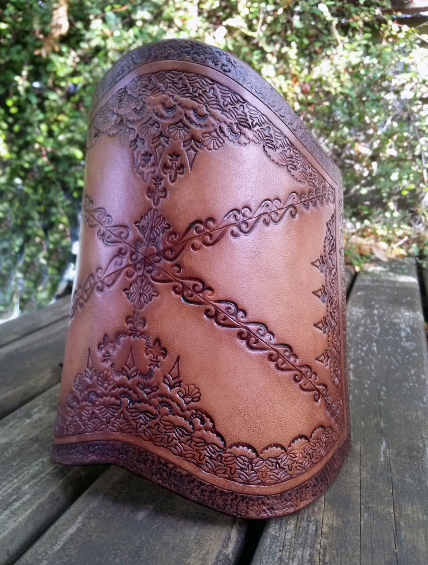

Made a bracer today. Two layers of veg tan, stamped, antique brown dye, glued together. The layers were glued on a curve to eliminate curve wrinkles and the bracer will keep its curved shape. Cheers caroline
