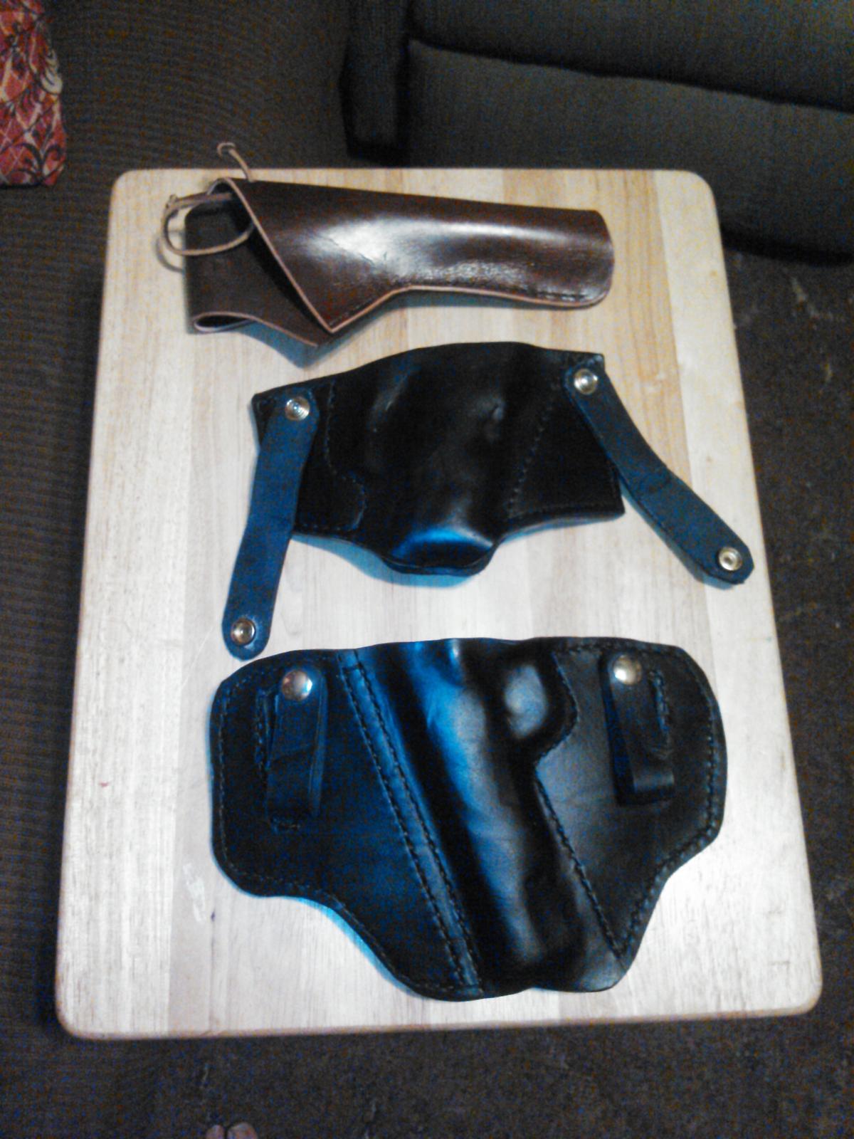

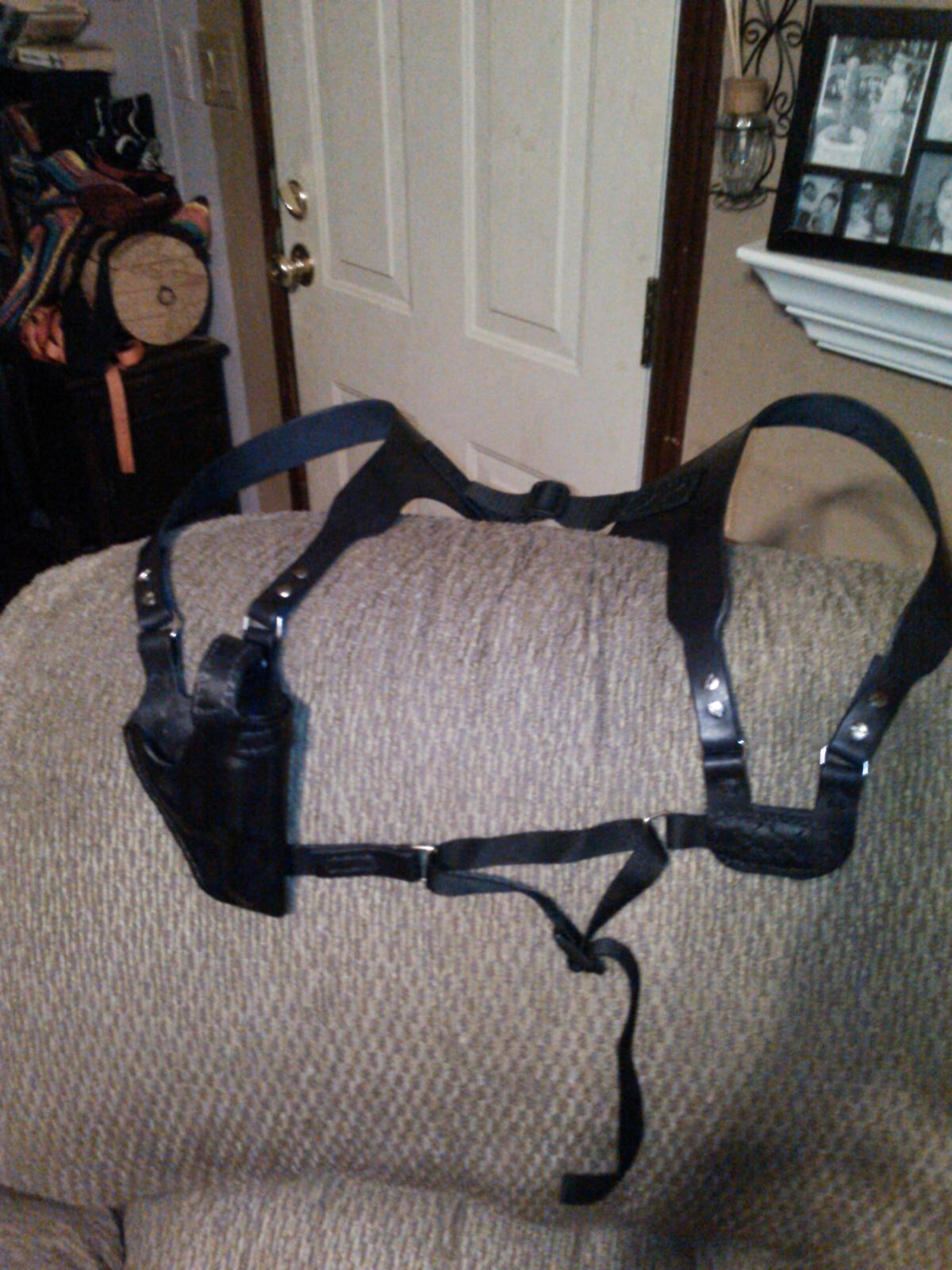

been away for a while and saw this post. not sure if you have solved the problem or not. I have not made a shoulder holster for a judge but have made several for revolvers and autos. I took a belt holster pattern I made and modified it to suit my needs. the shoulder straps were cut 7/8" wide for larger handguns and 3/4" wide for smaller ones. used 8/9 oz for each. Made a rectangular yoke for them to pass through and attached with rectangle rings then used chicago screws for adjustment. I have made vericle and horizontal rigs. if interested i can post a couple of pictures.

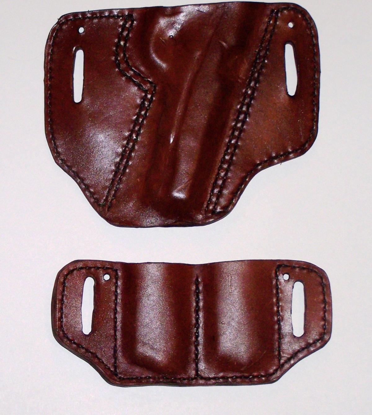

One Of The Latest Pairs
Sorefingers replied to Sorefingers's topic in Gun Holsters, Rifle Slings and Knife Sheathes
First of all thanks for the tips. I used 10/11 oz leather and had a hard time getting the holster to fit the piece wet. I was really concerned I had stitched it too tight because of the thickness of the leather. I did bone it too wet and then went back to try and correct that mistake which turned out OK IMHO but could have definitely been better had i waited. All in all just trying to improve a bit more with every one made. Thanks for the input. Keep em in stitches... Aaron -

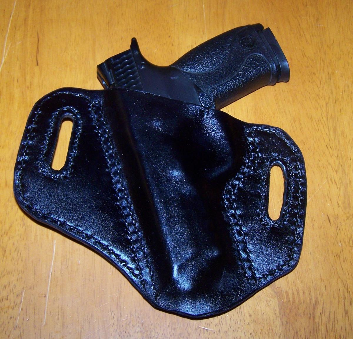

A Few More
Thank you. Black seems to be what my customers want. I sell black holsters 4 to one of any other color. I don't know if people just think black goes with anything or something else. -

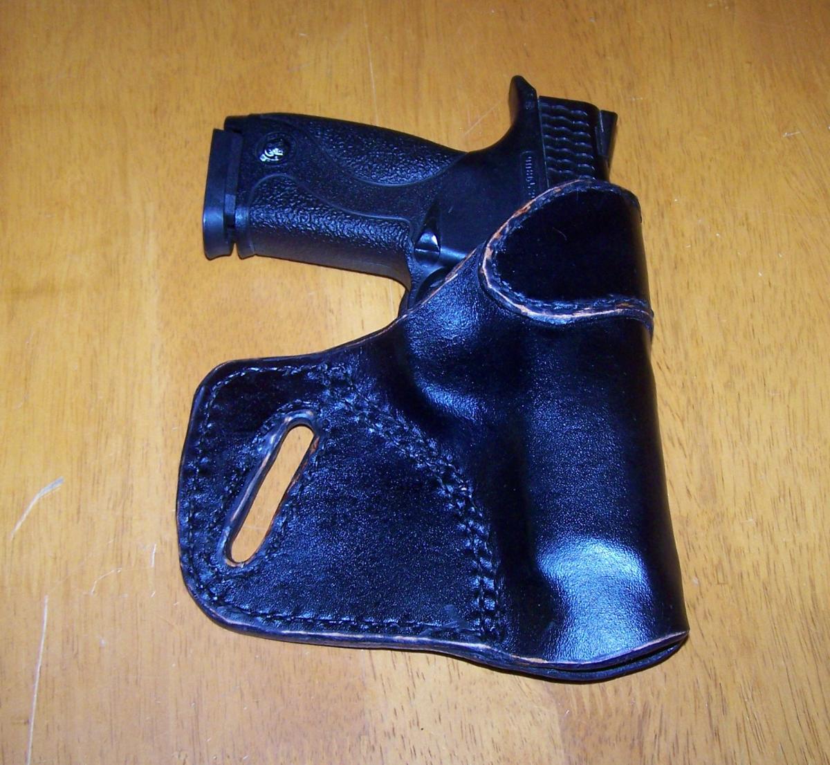

Here are few more holsters two are for M&P and one for 24/7. The high Riding M&P holster i removed a bit of the edge to reveal the the leather under neath creating a brown outline around the holster. looked neat to me.
