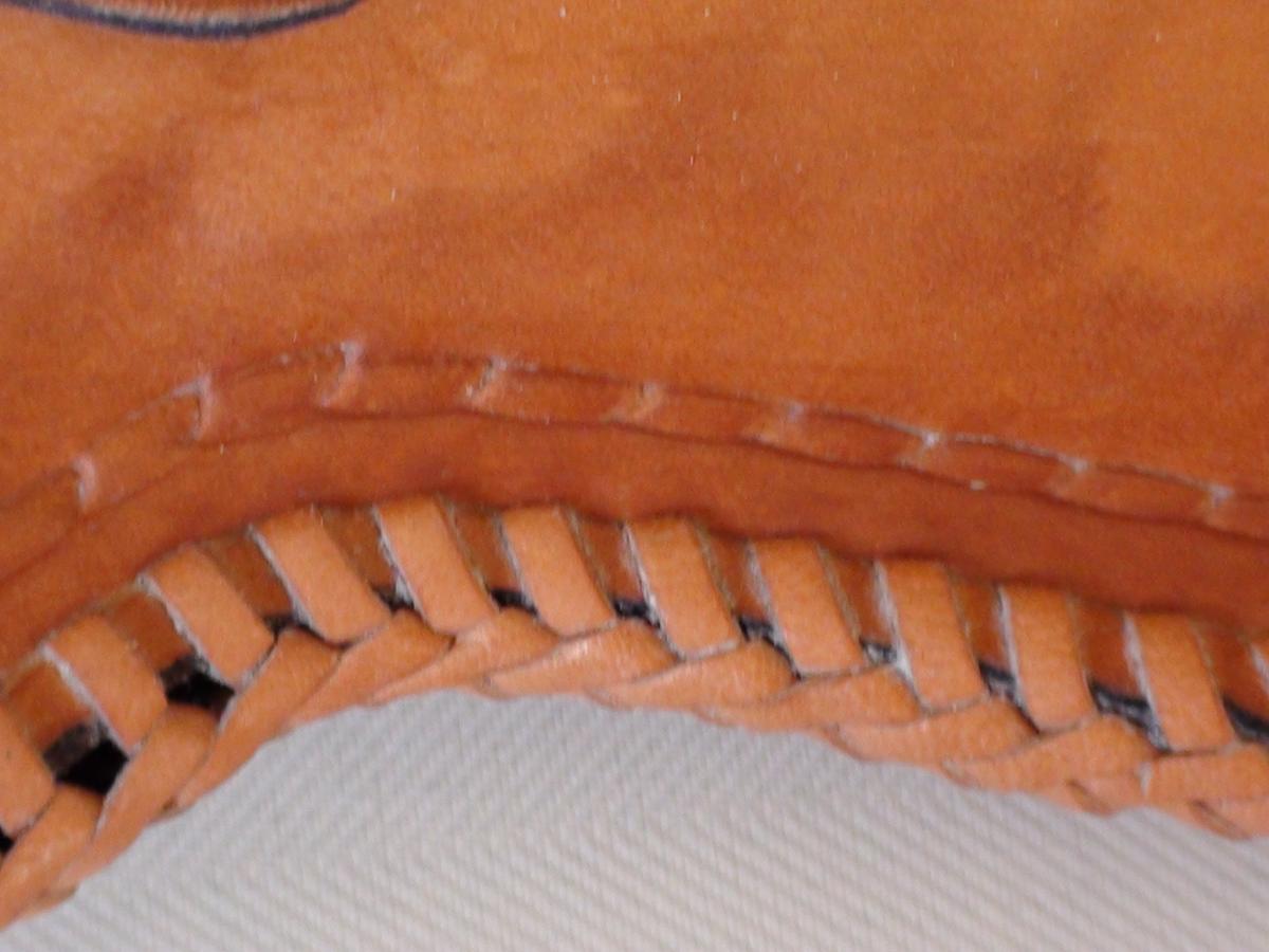

I'm trying it at this time. I never thought about sunburn being the problem. I had read of this in some place at some time previously, never thought of it. This very well may be the problem as I have just moved from a work room in our basement to my freshly finished loft above the garage. No natural light in the basement to lots of light coming in through windows everywhere. I will know shortly.
Hidepounder; Thank you for the quick reply. I will retry using your info. The method I was using has been fine in the past but from rereading the information I can understand that I'm wetting the leather but not truly casing it. Once again thank you and I'll see what happens.

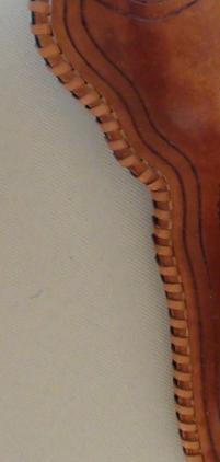

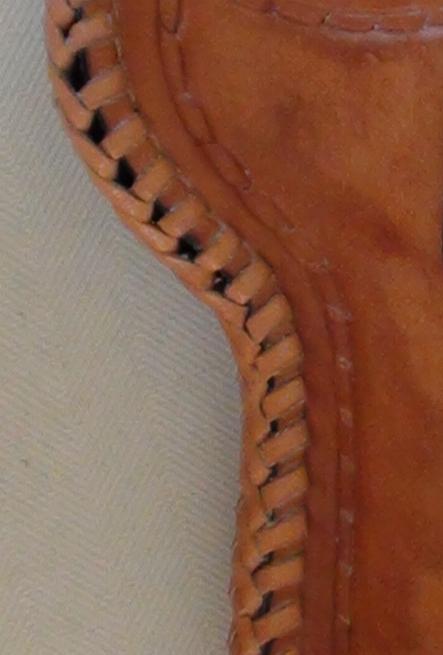

I case my leather in the manor described except I don't bag it. I put it in a plastic container of water until the bubbles just about stop and lay it out over night. The last two holsters I have done I have had them discolor (best way I can describe it) and have never had this before. See post in How Do I do That- Discolor Problem for pictures. I've played around with pieces of this hide and every time I case the pieces I end up with the same thing, dark and light areas. I'm starting to think it's the hide. Any input or comments would be great, as this one has me stumped.
