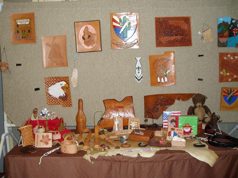

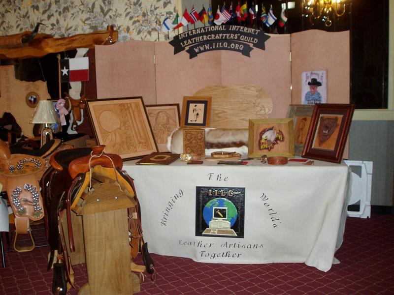

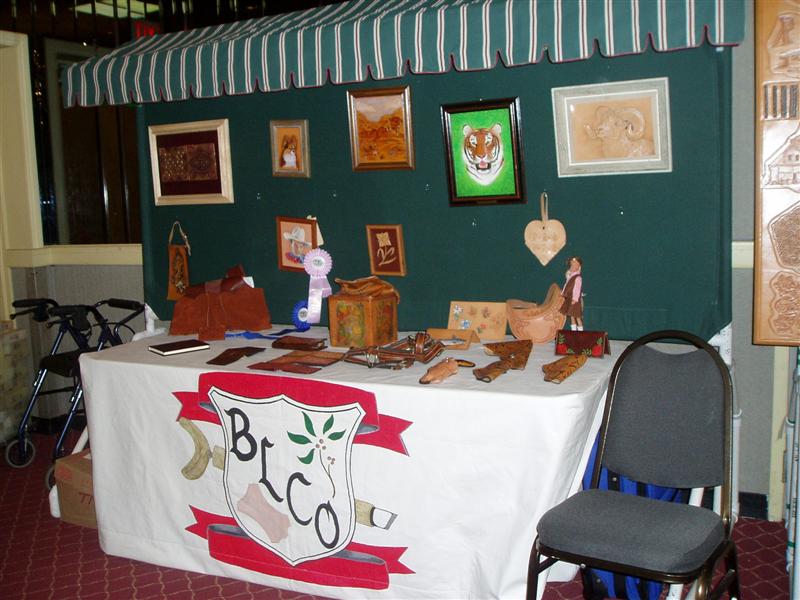

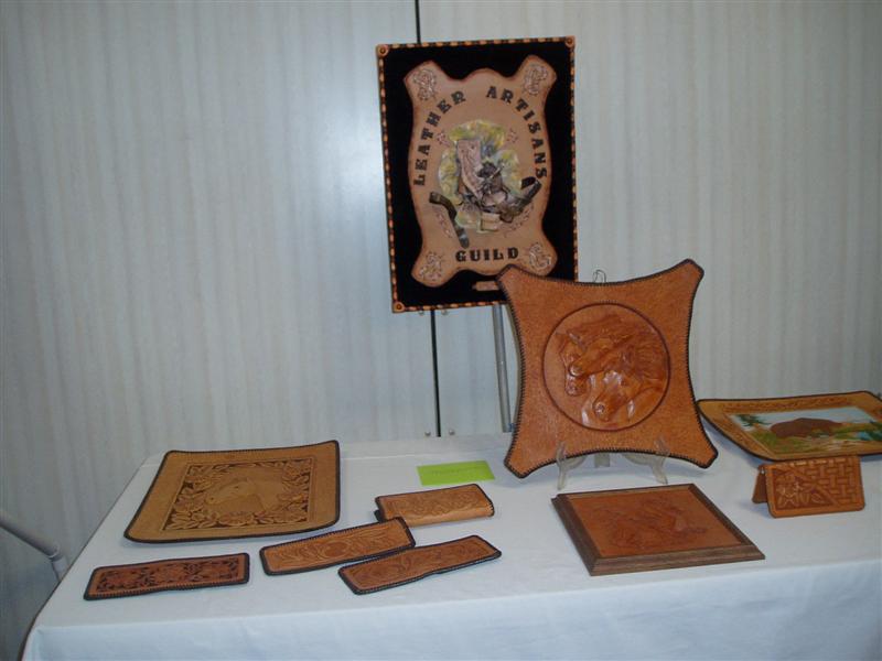

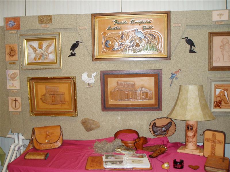

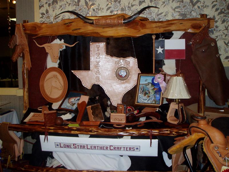

I just got in from Indianapolis. It was a terrific show! Lots of friends, leather and fun! I will post a full report tomorrow, and put some captions on the pics for y'all. Here is the link for the pics I took: http://leatherworker.net/CIL2007/index.htm Our ClayB won two first place and one second place ribbon out of three entries. Not bad, huh? (**hint- you've seen some of the work here on leatherworker.net already!**) If anyone thinks that people in the IILG would be interested in seeing these pictures, please feel free to post the link on the iilg-leather and iilg-member lists. I don't mind. More tomorrow! Johanna
