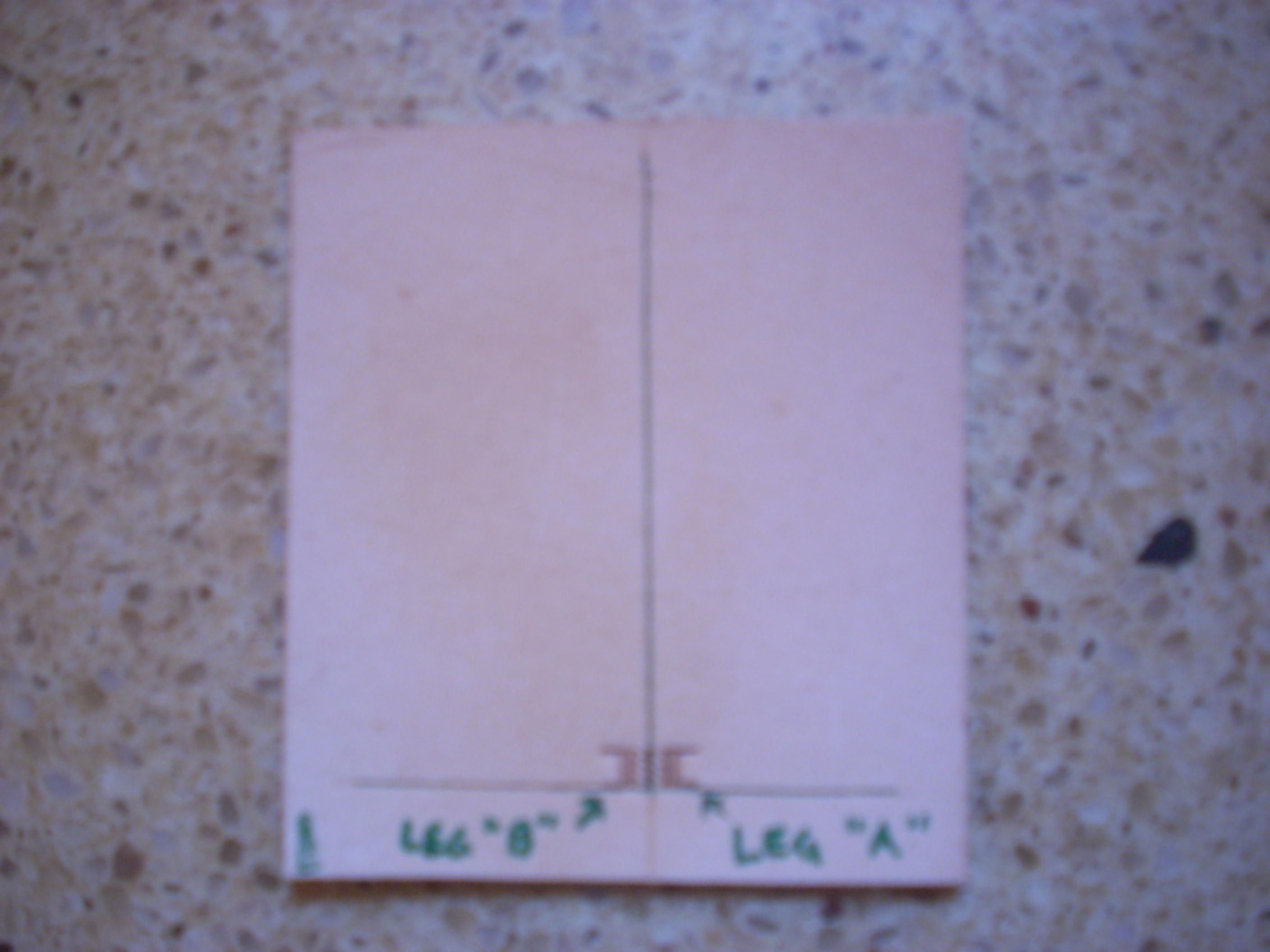

First off I did this really quickly. All of the lines and stamps are extra heavy so that you can see them. The first picture shows a project with a base and centerline. Place the bw stamp on the line with HALF ON EACH SIDE! 1-Stamp a faint stamp or just mark where the bottom right leg "A" touches the baseline. 2-rotate the stamp so that the bottom right (leg "A") is still on the mark and the bottom left "B" is touching the vertical line. this is the proper angle. Go up the right side matching the legs and touching the centerline. Do the opposite on the left side, Hope this was clear pete I give up trying to post the 2nd and third pictures! I am not real literate in this stuff- sorry folks, but I think that you will get the message.
It's kind of hard to explain but I'll try. To get the right angle the first time,take the example shown (vertical/center line down the middle) and place your b.w. stamp horizontal to the right of it so that it is laying across the bottom and the left top and bottom legs are touching the vertical line. Gently tip the stamp to the right so that the bottom right leg is STILL touching the base line and the bottom left leg is touching the vertical line . It's a subtle move but if done correctly the rest of the stamps going up the vertical line will just touch the center. no measuring pete I "think" that Bruce Johnson did a tutorial awhile back on how to run a stamp along a border with the proper angle. Same idea but you are using a center line instead of a border
