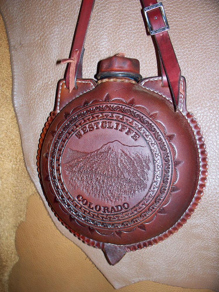

I posted these pics at the end of the tutorial the other day, but wanted to make sure the folks that are going to build one saw some other options. This one is scalloped around the edges and I also made a different collar for it to help hide the neck of the canteen and give you a place to tie the lid leash. I also stitched this one up and wet formed it. let it dry and cut the stitching out. Then I dyed and finished it and stitched it one more time. I love the look of bright white thread that you tend to lose during the finishing stages. Anyway here it is. Tim

Just thought I'd post up some pics of another canteen I just completed. The edge of this one is scalloped and pear shaded. I am also including a pic of the collar I made to go under the cap to hide the blue canteen. On the back of it i made a hole thru one of the scallops to attach the lid leash to. Tim

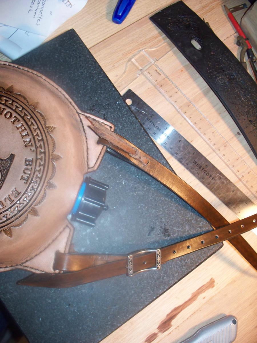

The strap of the canteen can be made any way you want. For this one I used a conway buckle from Jermiah Watt. It is stainless steel and very, very nice. For a saddle canteen I usually keep the strap fairly short. Somewhere around 18-20 inches long. I like to tie the straps on with leather thongs and tie them off with bleed knots. For a saddle canteen I put a twist in it so it stays on the saddle horn better. The last tip I will give is to slip a cardboard paper towel or tp roll over the neck to keep it clean when you are dying or staining the canteen. This customer wanted this canteen to be finished in a "rustic" fashion so that is what it is. It can be finished much much nicer and given a way more refined look if that is what you want. Well there it is................didn't plan on it taking this long but I wanted to be thorough. Hope it looks interesting enough for you to want to make your own or at least use some of the tips I've passed on. If anyone has any questions, don't hesitate to ask. ............and if you've stuck with it this far....well thanks for that too!!!! Tim Jones Drunk Horse Custom Leather Pueblo West, CO

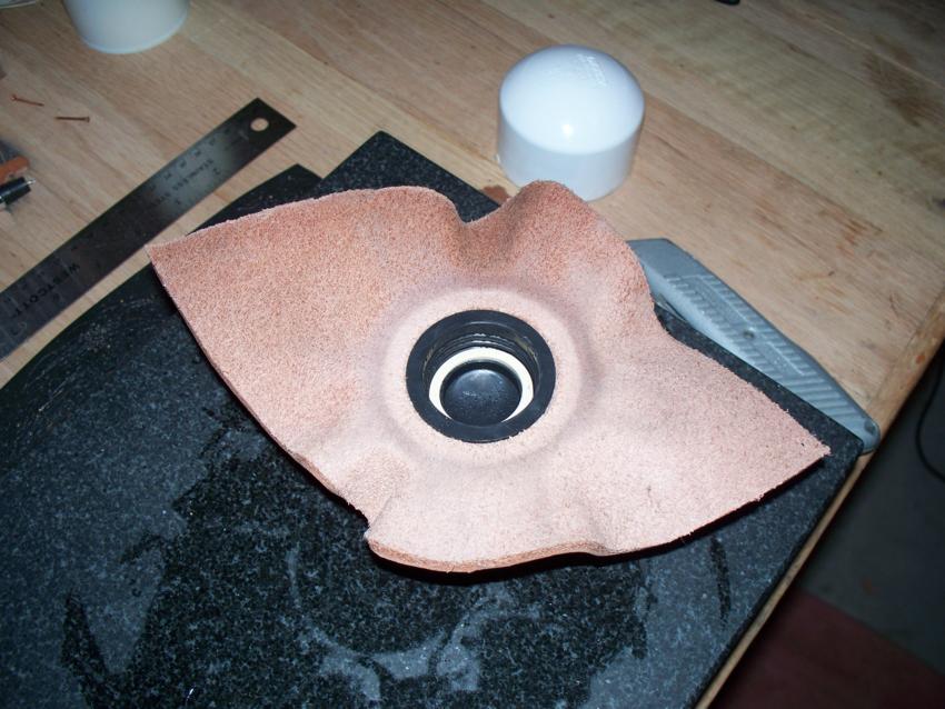

Now it's time to cover the cap with leather. The perfect piece of leather for this job is that stack of flanky, stretchy belly pieces that you don't ever have a use for. Allow yourself plenty of excess. I usually start with a piece 5-6" across in both directions. Throw it in a bowl of water and let it get good and saturated. While it is soaking I will cut the little button off the top of the canteen cap. Set the cap down on your rock or other hard surface and put the well saturated piece of wet leather on top of it, keeping it centered. Now take a 2.5" PVC pipe cap and drive it down over the leather and cap with you mallet. The trick here is to have drilled a hole in the top center of the cap to let the air out. Without the hole it will be really hard getting the cap to go down over the wet leather. You're going to have to smack it pretty good, but be careful and not smack it too hard or you can break the canteen cap. You also have to judge the thickness of your leather for this as well. Too thick and it won't go over the cap. Once you get the 2.5" cap driven down over it and it is nice and even all the way around, take a 3" pipe cap and slip it down over the 2.5" cap and press it down and turn. Keep doing this until you get a good ring going. Take the 3" cap off and set it all aside for 4-5 hours and let it dry out some. Once it has dried a little put the 3" cap back on and press and turn some more. This time it will leave a nice burnished ring. Take all the caps off and set it aside and let it dry some more. Before it is totally dry cut off all the excess leather up to the outside circle. Now roll the edges of this until they are sticking up out the pipe cap. You can also use the 3" cap for this purpose too. Set it aside without it being in any of the pipe caps and let it dry totally. When dry take the knife of your choosing with a sharp blade and trim all the excess off even with the bottom of the plastic canteen cap. When that is done and even all the way around, use your edger to round off the square edge you just made. Now you can burnish it and finish it as normal. When you are done finishing the cap be sure and glue the leather to the plastic. In this case I riveted on a small thong that I will use to keep the cap from being lost. I also make a keeper for the other end of the thong that goes around the neck of the canteen.
