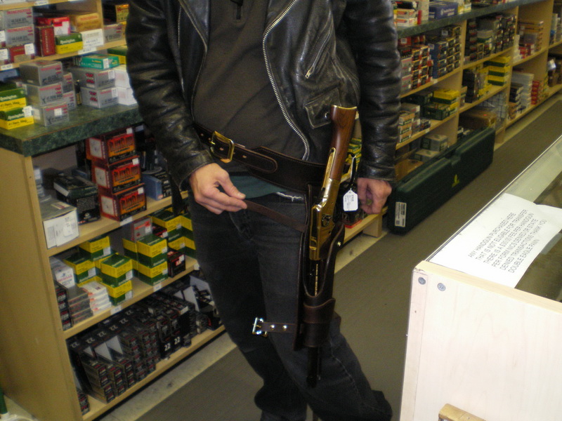

  9. I am finishing up this mare's leg holster for my brother who lives in VA and I live in WA. So gettting the right fit was a challenge. I used my Marlin 1894 for the pattern and once I had the holster made i went to my local gun store where they tried the pistol out for me ( see picture). My brother is wrong handed so I had to make an enclosed holster. The saddle ring is on the wrong side for a leftie otherwise I would make one similar to the one from the show "Wanted, Dead or Alive". Notice the gun store guy is holding the retention strap in his right hand. I did not know where to place the snap. So that was one of the main reasons for trying the fit at the gun store. I had so many folks talking to me about the holster that I completely forgot to mark the snap location. One more trip to the gun store. Also, the gun is not pushed down tight in the holster in the picture. It does fit. I would be glad to share my pattern. Just cover the cost of postage. If you are interested, please send me an email. Thanks, Jeff

  17. Shooter, That is one of the best glock holsters I have seen. I think glocks are great pistols but are very ugly. That holster really compliments a good gun.
