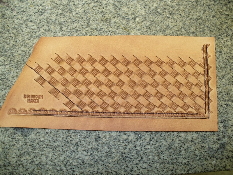

Continue stamping until you have filled your area. Carefully stamp your border (two different ones shown) and don't forget to sign your work! The last photo is a set of templates for all your different stamps. Be sure to number/name each one to correspond to the stamp used to make it.

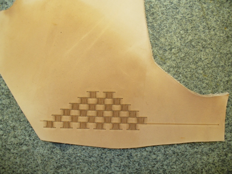

Its going to work this time, I hope. Somewhere along the line I lost a couple of my first photos so there is a lot of info related to this first one. If you get confused let me know and I'll take some additional shots and post them. In the first picture, get a piece of good, firm leather about 3" x 5", draw a base line close to edge leaving enough room to stamp one row between the edge and the line. Stamp a good base line along this line. Then stamp about 6 rows up, creating a slanted line by stamping one less impression on each next row. I'm left handed so most of yours' will be the opposite direction. Now cut a straight line along your baseline. Lay your straight edge along the edge of the diagonal impressions and cut that line. I then cut the third side of the triangle at 90 degrees to my base line This is what you should end up with. (Angle on the left side for all you righties). Carefully glue this triangle to a piece of firm plastic. I use a piece of laminate countertop material. Any cabinet shop should be happy to give you some "scraps" that are plenty large enough. I have inked these lines for visibility. The bottom horizontal line is your outside border. The top horizontal line is where you stop stamping the basket weave pattern. The angle came from laying your new triangle template on your base line. From here, place the stamp on this angle with the lowest tip just touching your base line (for righties get this starting point as close to the right side as possible so that you are stamping right to left). Keep stamping until you have a completed horizontal base line and an angled base line CONTINUED ON BASKET WEAVE POST #2
