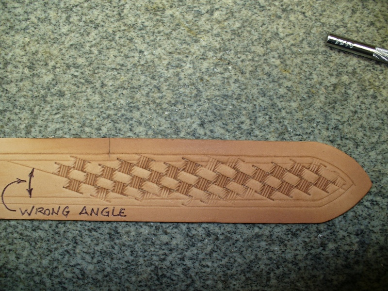

I GIVE UP ON PHOTOS!!!
Just can not get the photos to come out right! Hopefully you can see the difference above between a correctly stamped belt and an incorrect one! Thanks for looking.

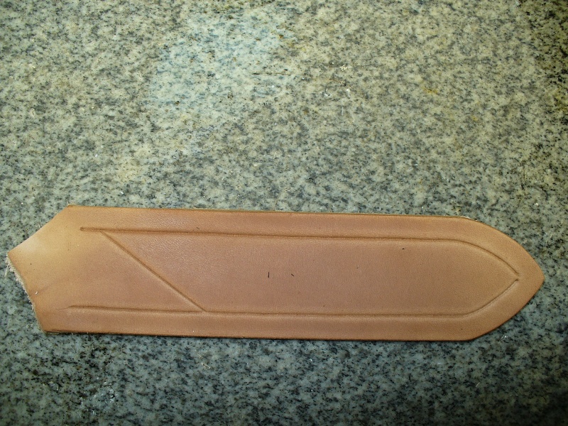

Next is a belt. Lay out your base lines the same way. You can lay a ruler on the opposite side of your angled line and scribe a VERY LIGHT line down the belt several times. This gives you a reference to keep your angle correct. Stamp the full length of the belt and repeat til you get to the other side, stamp your border and you're ready to go.Looking down your belt at a flat angle, you should see straight lines running the full length of the belt. This is what happens when you use the wrong angle for something as narrow as a belt.
