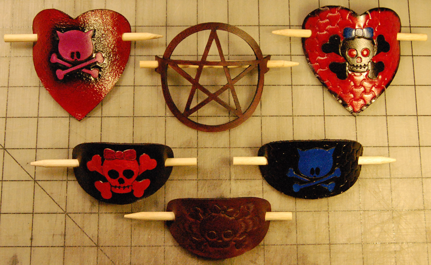

all of these were made using scrap leather. figured a good way to use it up and get some more practice tooling while trying to figure out the truncated cone thingie. the border on the red heart on the righthand side was an accident. started doing the edge with a sharpie and I guess the super sheen wasn't quite dry yet so it pulled the color into it. think it looks okay though. the ovals are 4" by 2" and the hearts are 4" by 3 1/2". now let's see what you guys come with it!

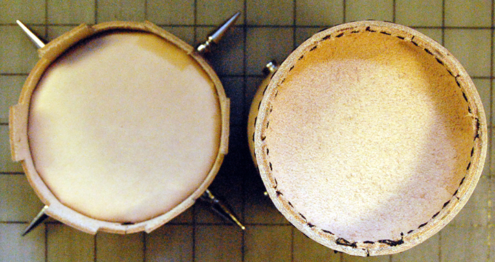

forgot to say what I used and here's the rest of the piccys. 2 1/2" electrical pipe cut to 3/4" width for the snap support, line 24 snaps attached the tower with large rivets and small caps, 1 1/4" rivet spikes to attach the other half of the snaps, 5-6 oz veg. tanned leather. straight sewing done with me tippman boss, handstitched down the back (ugh!). cased using lexol first then once it was soaked in, water in a spray bottle and wiped with a sponge to even it out and tooled immediately with almost no soak in time for the water using tracing film on top.
spider I cased the leather like I would before carving, but instead of letting it dry/soak in a bit, I put the tracing film on it and pressed hard with the stylus to make the lines and color/burnish the darker areas. no cuts on it at all. tony it's a dice cup/dice carrier for gamers... or beer smuggler! *L* beeza yeah it does! wasn't happy about that at all. I hate wasting leather for any reason.
