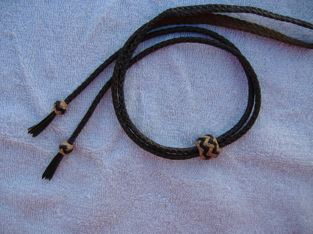

    your braiding looks pretty good... i personally like a little swell in my nose button and a little different shape to the heel knot. things done differently? im wondering about the spacing of your noseband at the heel knot...was there a reason you made such a wide spacing? and i would have probably put a ring knot just above the heel knot to keep the noseband from stretching the top of the heel knot braid when its shaped and such. im glad you enjoyed the roo. after working onlywith the roo for so long im finding learning the rawhide a rough road.
  11. alan so let me make sure im getting what your doing....where i start mine about 1/3 the distance from the end of the knot, then wrap the strands on until i reach the end make my bights, braid down thru the wrapped ends of strings then wrap my working ends for the remaining 2/3 of the knot then turn back make my bights braid back to the ends of my strings at the 1/3 point where i start building pairs...you are basically skipping the wrapping process by doing the skeleton braid right from the start? is that correct? if so then that is probably easier to do as it is hard for a rookie like myself to correctly guage the space to leave between strings when doing that initial wrapping on of the strings. COOL! learn something new every day! the interweave doesnt work if you do the gaucho pattern does it? thanks again
  12. alan this is great, thanks for doing this. what knot are you doing for the nose button? i noticed you have strings going in both directions and did not recognize it...i just use a multistring knot from b.g.s book and you only have strings going in one direction. yours looks very interesting. i like the lines drawn on the foundation to keep it straight..excellent idea will have to try that for next time. now i have to build a bosal so i can try the interweave...havent been able to get one done yet.

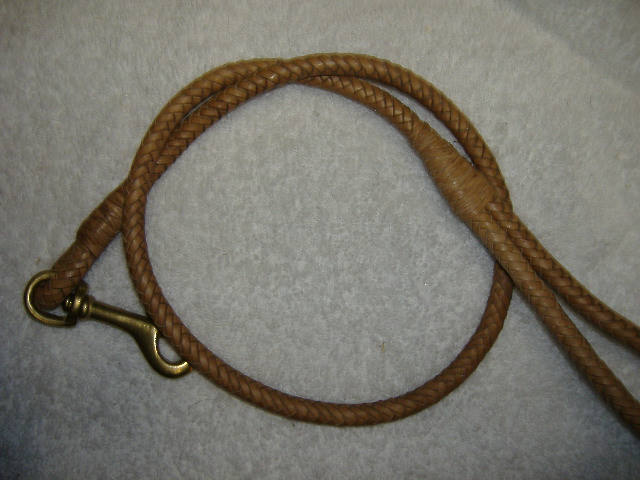

    some of our work
    entiendo- yes i do turnbacks...i just call it braiding back the ends, thats whats under the knots, its real easy to do when you use the two prong lacing needles. the harder thing is when using a rope core i cut the ends at an angle and then stitch the end down to the body of the leash you have to be very careful not to damage the lace when pushing the awl needle thru, the stitching is the main reason i use the knot. on the 8 stranders i braid them back cut the ends off and cover with a knot, on the 4 stranders i braid them back cut two off and use the other two to make a rein knot, this is the signature look of my leashes, my makers mark if you will, plus i dont have to worry about ends coming untucked as ive seen with other peoples leashes. we've made literally thousands of leashes in the 10 years weve been doing this. alan-ok duh i should have guessed it was ron edwards, although ive never looked at any of his books, they are on my list. is the trenza in one of his books? the braid i did is a 4 step pattern like the 8 strand gaucho round braid, you go over under over on side 1, under over under on side 2, then under over under on side 1, followed by over under over on side two. gives you a double edge and a nice pattern in the middle. bruce grant calls it the double braid but also says that it is characteristic of the argentine where it is called trenza patria. there are some pictures of cinchas in b.g.s book that are made of horse rawhide-incredible work. yes i saw those reins on the tcaa website, i drool over the work of all of the tcaa braiders. i havent tried braiding rawhide yet, so far ive only worked in roo, so id have to really work on that to catch up to the curve before trying to learn from someone like nate wald. gives me something to aspire to anyway.

    some of our work

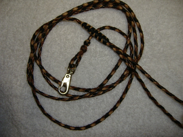

    yeah i know my digital camera sucks cant take closeups at all...i also took pics with my real camera but have to get the film developed...im hoping the ones of the gaucho braid lead will really turn out well, but i dont know as it was very fine strings. i have used pineapple knots in the past but really like the 2 bight turkshead as it really lays down nice and smooth so adds very little bulk presents a smoother line when someone might be using it in the ring.

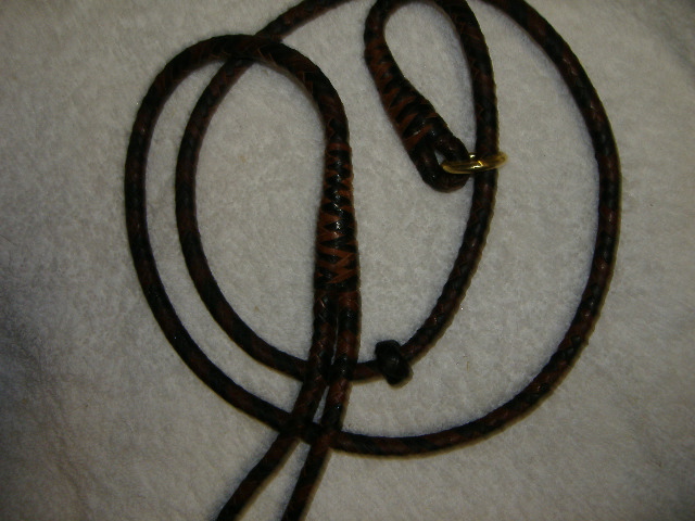

    thanks for the comments. i got the trenza from bruce grants encyclopedia the 8 strand double braid he calls it and says its from south america, so maybe not a true trenza patria but it came out with the same pattern as the 8 strand gaucho. digital camera didnt do it justice its awesome. i love the gaucho braid but it is a pain to do, this was the first time i braided more than a couple of inches of it. my mom took one look at it and said you do it. took me two days every time i lost my pattern i had to unbraid until i recognized the pattern again. im going to try incorporating the flat braid into a headstall, ive experimented with it and it is easy to go from 12 to 10 to 8strands using it, and the dropped ends are not visible and keeps the same pattern so i think it will make a lovely browband. alan- ron who ? and what flyer ? everything ive learned ive picked up from bruce grants books. though nebraska now offers artists grants to study with master artists, this is the first year they are offering them, so may try to find a braider to help me improve my technique. no braiders in nebraska as far as i know though so will have to go out of state. i really love the knots he calls the botons but what do you use them for your average person doesnt really care how long it took to tie the thing just why does it cost so much.
  18. hi all...thought id post some pix of some of our work...something besides paracord. i cut the lace do all the prep work and setup, my mom does the straight braiding, then i do all the finishing, any knots etc. not a good picture you really cant tell the patterns but this is an 8 strand gaucho braid with the flat handle and throat being 8 strand trenza patria (double braid) 5 different 8 strand leashes all knots are 2 bight turksheads better view of the natural 8 strander 8 strand slip leash with 2pass ring knot for a slider and 2 bight turksheads this is an 8 foot german shepherd lead with braid over snap and 3 bight t.h knot 4 different colors showing a bunch of leashes nearly ready to go out various colors different view same leashes another view trying to show all the colors. i dye all the reds yellows blues purples greens teals etc myself a nice little 6 strand bolo tie done a couple of years ago slider and end knots are pineapple knots frills on the ends flat in the neck.
