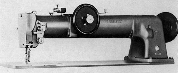

	FYI Here is a list of industrial machines including the 144's, I see yours has the extra long arm at 30". http://ismacs.net/singer_sewing_machine_company/model-list/classes-100-199.html Singer did use the same castings for multiple machines sometimes, it may be that you can also use the lower casting from another machine model. This kind of parts interchange is well out of my knowledge. Good luck searching.

	It would help to know the sub model of 144. The 144w came in several sub models with different arm configurations in long arm, high arm and regular. All would have different lower castings.
