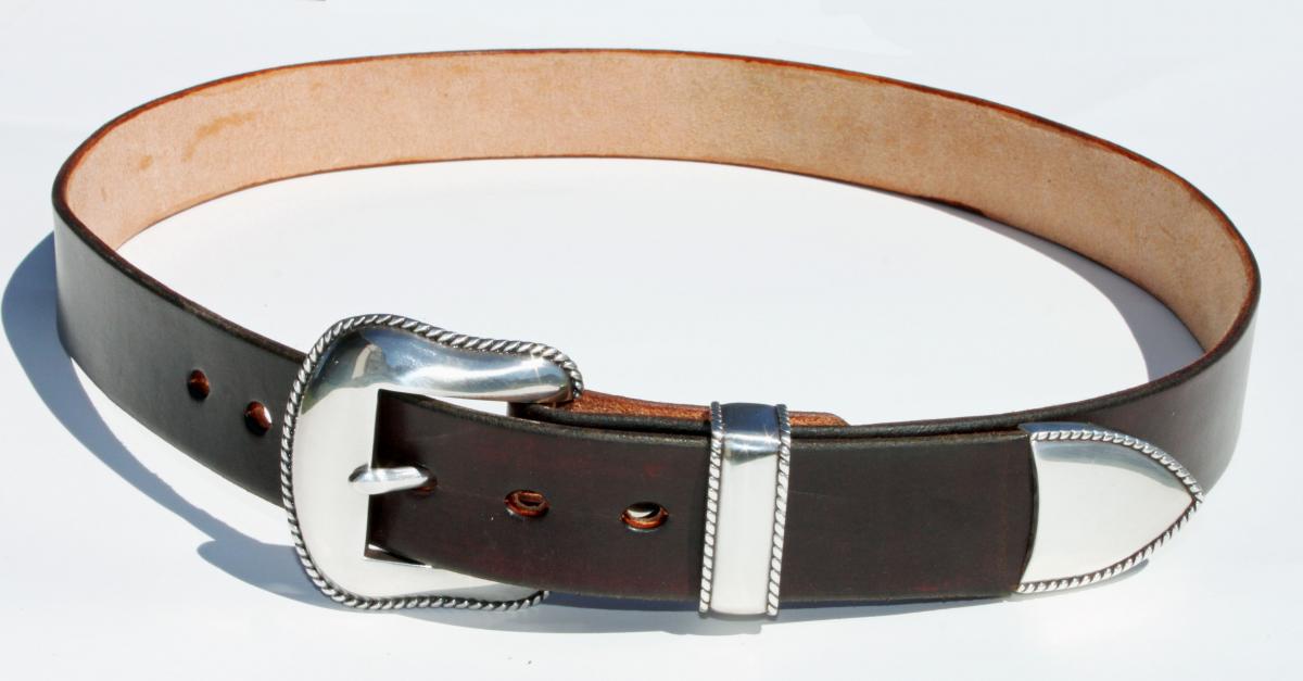

These are a little different than Guitar Straps. This one the customer provided the buckle set, it is a Vogt Sterling Silver Buckle Set. The strap is two layers of 4/5 oz Hermann Oak and the front and rear straps are 7/8 oz Herman Oak. It was dyed with Fiebing's Pro Oil Black, conditioned with Fiebing's Aussie conditioner and finished with two coats of Resolene (50/50). Chief

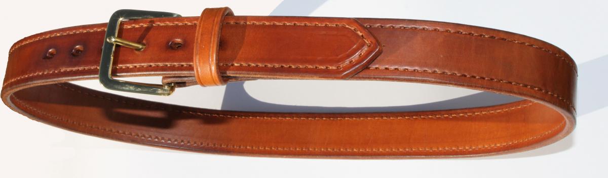

I wear a Glock 19 every day on a single ply belt, the belt is about 6 years old and doesn't give or show signs of wear. So my answer is yes a normal belt is plenty, however, a lot of customers are convinced they need the extra heft, so I sell it to them. I never argue. If it were a Ruger .44 Mag with 10-1/2" barrel then maybe you would need something more, but who'd want to wear that "Hawg" every day or any day. Many customers think that a double belt should only cost twice as much, nope!!! You got gluing, sewing, not to mention when I do them, the bottom blank is 2" which I contact cement to the 1-1/2" blank then trim to width. Personally, I don't like the feel of the laminated belts, they are too stiff and bulky for my taste. I think the idea behind the double belt comes from customers buying a 1911 or such, putting the holster on a Walmart Belt then when it wears out in about 10 minutes (just an estimate), they are convinced they need double to prevent that. That's just my opinion, I could be wrong, that happens a lot more lately. Chief
I may catch some flack but I don't normally make mine "Double" thickness. I make them two ways, one is I use a normal thickness cut from a belt bend which is normally 9/10 oz and then laminate a 4/5 ounce to that, I then skive the end just as I would a single layer belt before I stitch the belt or I laminate two 6/7 oz strips, when I do that I stop the second layer at the same place I would normally skive then feather it with a hand skiver. I don't have a preference both are very strong and very durable and look about the same once they are glued and sewn. Chief

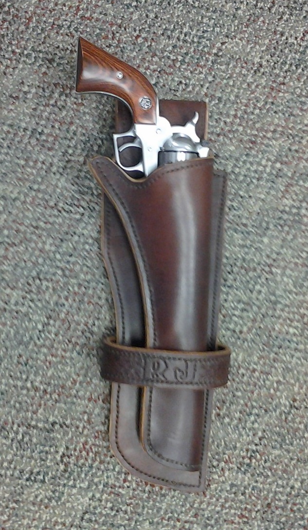

Made this for a customer, Ruger .44 Mag 10-1/2" barrel. The holster is 7/8 oz laminated together for a total of 14/16 oz. The thing goes past my knee when wearing on a belt, hope he ain't thinkin' about no fast draw, you got to get it up nearly to your shoulder to get it clear of the leather. Oh well, I suggested a cross draw but he wanted a western style. Chief
