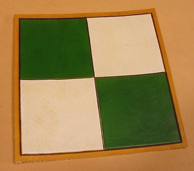

White is a very tough color to work with. But I've tried a couple of things that worked out fairly well. A lot of people don't like Fiebings white dye. It doesn't look very good when it is hand-brushed on, but spraying it on is another matter. Here's a color sample from a project I did a while back, in which I used Fiebings white dye, sprayed from an airbrush: Note, this piece had antique applied, so it's not the pristine white you may want for a wedding piece. That can be left off, of course. Another possibility is Krylon spray paint. Amazing, but true. If you don't have an airbrush, this is what I would suggest. It obeys masking very well, and if you spray it on in light, multiple coats, it saturates the leather evenly. Both products produce noxious fumes, so be prepared to use good ventilation and wear a respirator. Kate -
