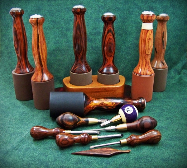

Hi Everybody, Here are some of the projects we made during May. Beary is making lots of Burnishers, & sending them before I can get any pictures. I'll have some pictures in the next few days. The 17oz maul laying down, is made with some Presentation Grade Cocobolo,,, some of the nicest I've ever turned. That one hasn't been sold yet. I may just have to put that one up for bids someplace. Thanks for looking,,, Ed the"BearMan"

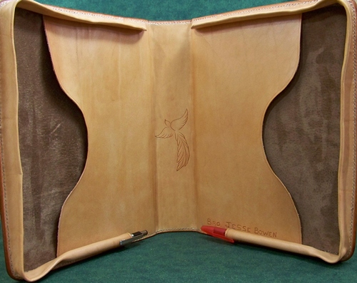

Thanks for all the wonderful comments,,, Here is the only picture I have of the insides. They wanted a welt/flap around the edge, like what they had in the one they have now. I think next time I may insert some stiffening material in the welt, just to keep the lines straighter. Thanks,,, Ed -

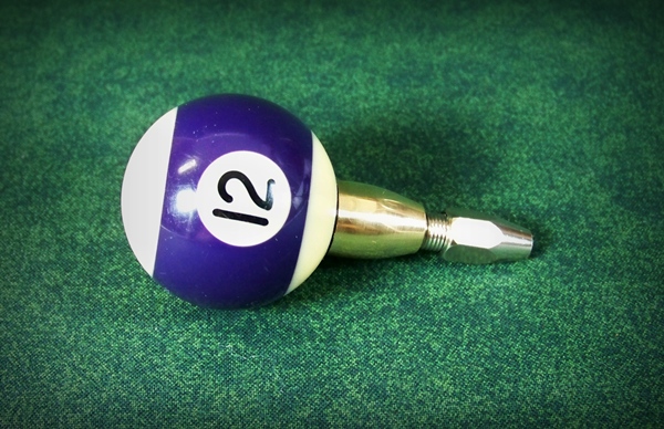

I was able to find the Pool Balls a lot quicker than expected. Mike, BluesMan, & Chris, I have your numbers set aside. Here are the numbers I have left: 1,2,4(x2),5(x2),6, 9(x2),10, 11(x2),12(x2),13,14(x2)15,,, & 1 cue ball. Thanks,,,
Hi Everybody, Well,,,, I guess I need to find my "stash" of pool balls,,, so I can figure out what numbers I have. If I have those numbers, I will put your names on them. Good thing I have today off,,, hehehe So far, the only numbers I'm sure of are: 6,12, & 14,,, but I know I have a bag of balls in a box somewhere. Thanks,,, BTW, the collet that actually holds the Awl blade, has 2 slightly different sizes, so pretty much any awl bade will fit. The Awl blade pictured with the "Stinger" is just for demo purposes. Thanks for looking,,, Ed the"BearMan"
