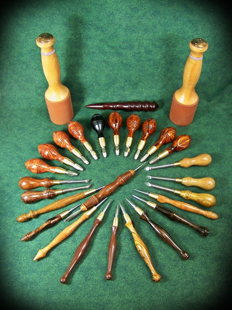

Hi Everybody, Here is a lot of the things I'm taking to the Denver show. The BearMauls range from 11oz up to 26oz. Several "Stingers" made from many different types of wood. The front row of the Stylus's (?) are my usual design with several differnt designs in the back. And of course some more assorted things, slickers, petal lifters, & a BearSpike. If you're going to the show, please stop by & say Hi. Thanks,,, Ed

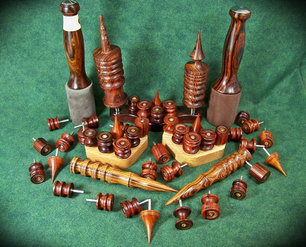

Hi Everybody, Here are a lot of the things we have for the Denver show,, so far. I'm planning on having 2-3 times as much of the "Stinger"(awl handles), Stylus, Petal Lifters, Modeling tools, and a couple other things not shown here. Of course we'll have a couple dozen BearMauls. Beary will have Lots & Lots of LeatherBurnishers on hand also. Hope to all my Leather friends there. Thanks for looking!! Ed the"BearMan"

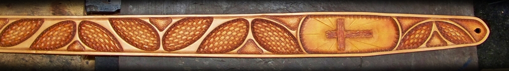

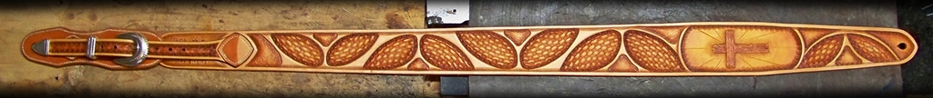

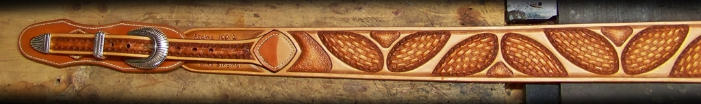

Hi Everybody, Here is a Guitar Strap for a local Christian Artist. It's the first thing of the leather bench in a while. He wanted it un lined, so I made it out of 10oz Herman Oak & it's 49" to the center hole. After tooling I rubbed in a good coat of Aussie conditioner, to make it more supple. After it dried over nite, I dyed the curved basket weave areas. After drying, I buffed it up with a soft brush, applied a NeatLac finish, edged, slicked the edges & sealed the backside. Thanks for looking,,, Ed the"BearMan"

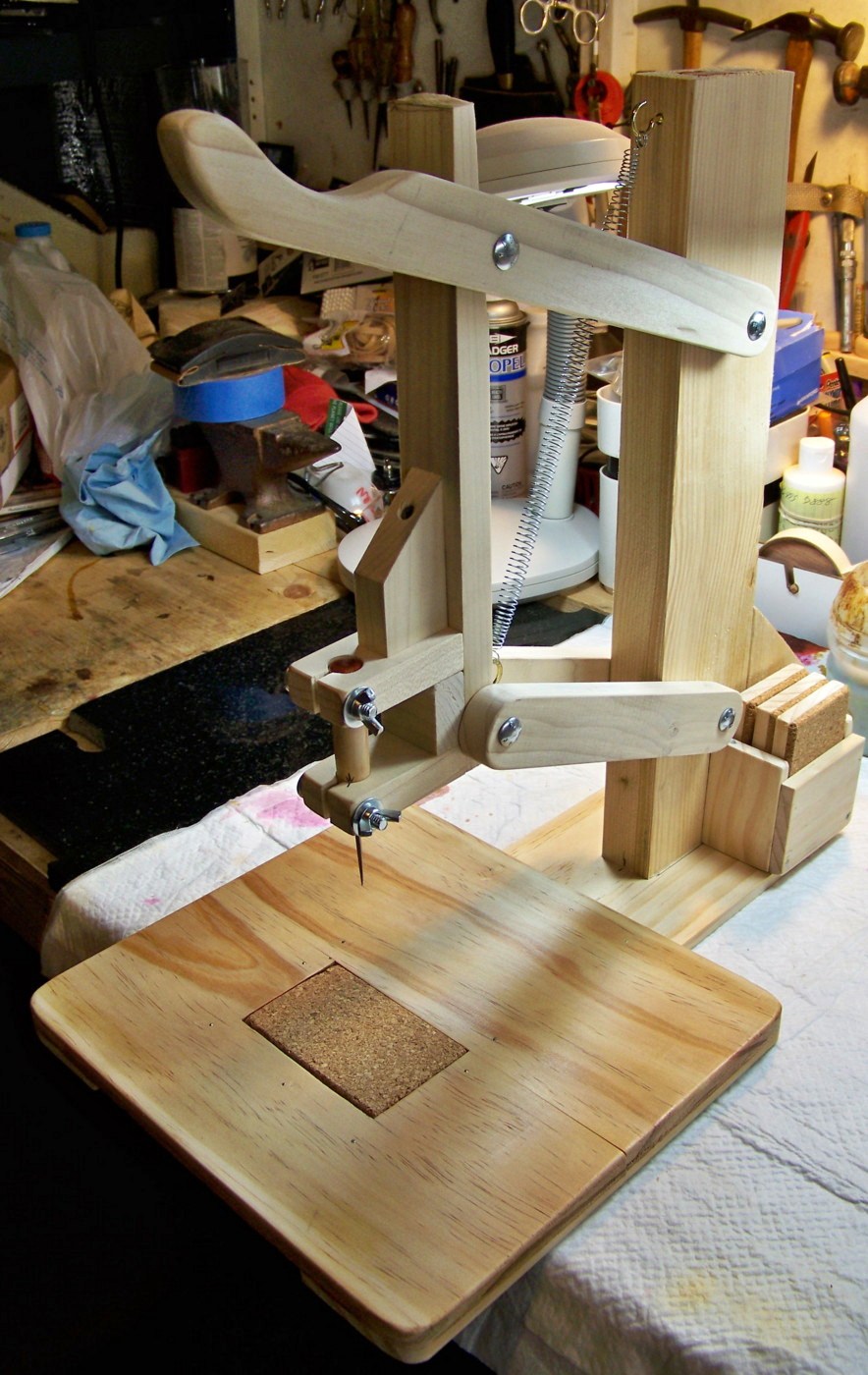

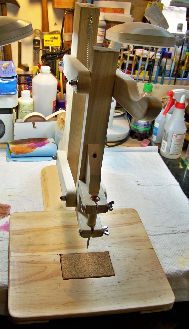

Hi Everybody, Here is something similar I made a few years ago. I call it the "Rapid Repeater" stitching hole puncher. It uses a Douglas blade, & it makes short work of making holes at the correct angle. Since the picture was taken I've added a light. About every 15 holes, I rub some beeswax on the blade. Hope this helps. Ed the"BearMan"

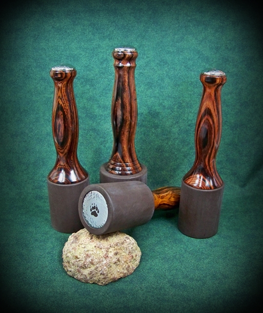

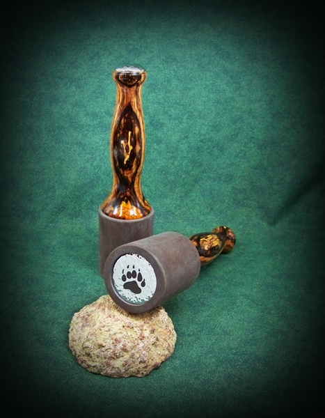

Hi Everybody, Here are a few of the latest BearMauls. 16oz, 18oz, 20oz & a 24oz Grand style. These are already spoken for. They show just a small sample of the different variations that Cocobolo comes in. There are also a couple different style head caps on these. Which one do you like the best? Thanks for looking,,, Ed the"BearMan"

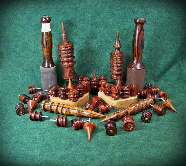

Hi Everybody, It's been a while since we've posted anything. Here are a couple recent BearMauls, with Very Striking Cocobolo handles. After all the Cocobolo we've turned, this is the first time we've ran accross something like this. Before the wood was turned, it had a lot of the Orange & Purple highlights. So, I believe as the wood ages, it will get a lot of the highlights back. These are 16oz & 18oz, with our new head caps. These aren't completed yet, so some small weight & head cap changes can still be made. Thanks for looking,,, Ed the"BearMan"
