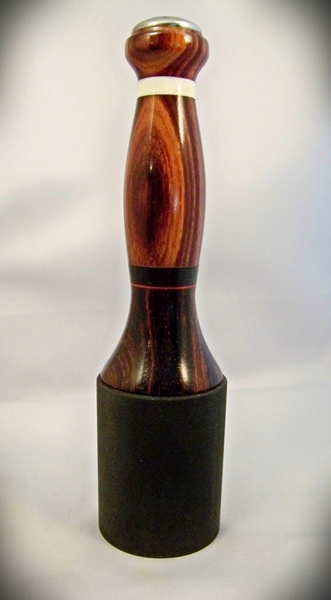

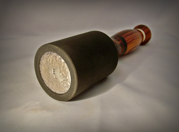

	Hi Everybody, Here are a few mauls I found while doing some packing. There is a 15 Oz maul with an "Elite" style handle, a 16 Oz Zebrawood "Grand" style, with a Faux Ivory spacer , an 18 Oz Cocobolo in the "BBS" style, & a 19 Oz "Grand" with a solid Faux Ivory handle & extra file work. I wanted to offer these to my fellow leather friends here first. If you are interested in any of these,,, just let me know. The 19 Oz Faux Ivory,,, has been "trained" through some use, & testing to see how the Faux Ivory would work / holdup. I will probably make more with solid Faux Ivory,, it works out pretty nice. Thanks for looking,,, just let me know,,, Thanks, Ed the"BearMan"

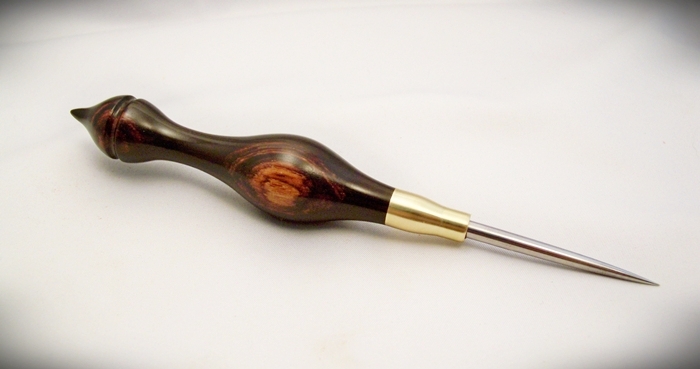

	Hi Brian, The only way that an awl will work easily, is if it's sharp, & smooth. 99% of the awls out there, you have to sharpen & polish, after you get them. If you can, avoid all the frustration, & get a Douglas awl. Sheridan leather has them. They ain't cheap,, but they are worth it! Ed

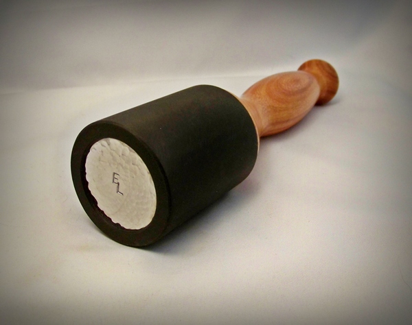

	Hi JDM, Cutting boards are made out of HDPE(High Density Polyethylene), which work great for cutting boards as they are tough, cut resistant, & slippery when put under any pressure. The slippery part is one main reason they don't work all that great as maul head material. But,,, that being said,,, it beats the heck out of nothing! Just make sure after you've assembled the maul, to sand the surface with some rough,,, 50 grit paper,,, to help give it some bite. Eventually, it will loose it's bite,,, & the tools will start slipping off when you hit them. Just re-sand, & it will be Ok again for a while. With the cost of buying the hole cutter, the cutting board, & all the other stuff you need to make your own,,, for about $30.00 more you could get a 16oz maul from Barry King for about $55.00,,, also I believe my Son is still making the white head mauls for about the same price. But,,, what you have in mind will work. Hope this helps,,, Ed the"BearMan" P.S.,,, making a rawhide head maul is a LOT more work!
