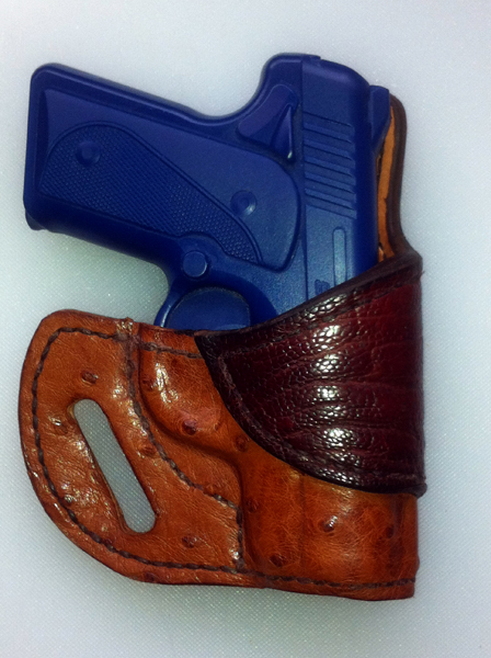

Yes. I burnished them first. -

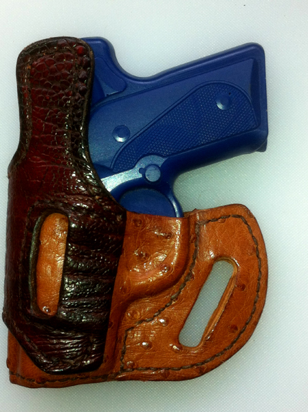

Thanks guys. I wanted to send it in a nice box and the cigar box was much nicer than ones I found at hobby stores (and a LOT cheaper) Particle. I tried a marker on scrap piece and it did bleed in. Ostrich leg apparently is very absorbent. About the only thing that prevented bleeding was to use 50/50 diluted resolene. Seemed to prevent bleeding but still allowed to dye. Will experiment more with that before I try it on a holster again. -
I made this for my brother. Kimber Solo. It is my first ever modern holster. It is covered in cognac Ostrich with a burgundy/brown Ostrich Leg reinforcement piece. I shipped it to him in a cigar box I bought at a flea market ($2) solid Spanish Cedar If you can see it I added an extra stitch line closer to the trigger guard. I hand molded it, then used a vacuum clothing bag to vacuum mold it as I used a bone creaser to work the leather tighter into the bluegun. Anyone work with Ostrich? Any suggestions to remove fur from back. I used a tabletop belt sander with shop vac to remove the fur. Also, when I started to dye the edge of the reinforcement piece, the dye soaked into the ostrich leg. Any suggestions to prevent that from happening?
