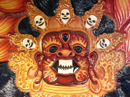

It's been awhile since I posted, and even though I've been doing alot of leatherwork, I'm particularly proud of this seat that I did for my husband. I would like to thank Peter Main for his encouraging words and promptness in sending his books about his coloring technique, without which I would not have been able to accomplish this project. His graciousness and expertise were kindly given to me via email and I'll treasure that interaction always. Along that note, I'd also like to thank the community at leatherworker.net. Even though I don't post alot, I've come to rely on you daily, just like my first cup of coffee and I don't know what I'd do without you all and the vast knowledge you are always ready to impart. Thanks for looking, Chris
