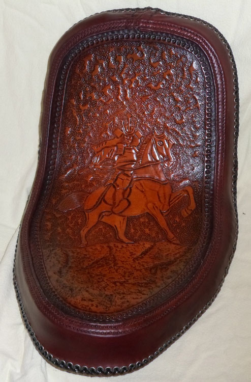

The tooled pieces on the top and bottom are 7-8 oz veg tan. The piece on the side is Nomad Oily Side from Tandy leather. First I coat everything with a few gernous coats of neetsfoot oil, some folks don't like neets foot oil because it can darken the dye but I like the richness it brings to the dye. Just my opinion. I let the oil soak in overnight. Then on the veg tan top and bottom panels I put on many coats of Kiwi neutral shoe polish. Apply, brush, buff, and repeat. I use a buffing attachement for my drill to buff with. I also use the same process to care for the seats after I have em on my bike, neets foot oil then shoe polish.

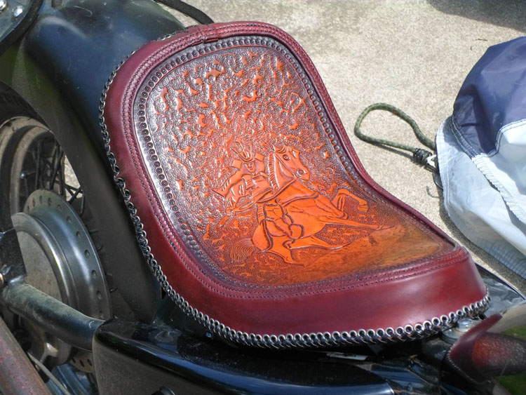

Here's the latest motorcycle seat I just finished. I posted more pics in the motorcycle gear section.

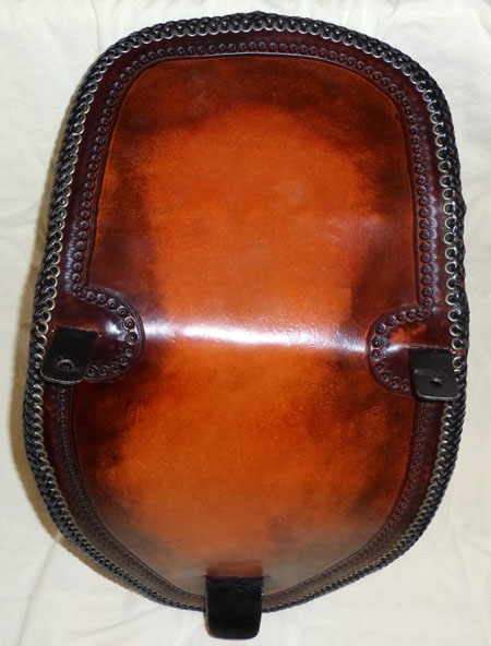

I wrap paper around the seat then I trace around the seat on the side the foam is on. This will give you the complex curve shape of the seat. I then use a compass to transpose the line to the bottom this gives me my pattern for the side pieces. I usually do two side pieces and stitch them together. I will add extra length to the bottom of the pattern dependent on how I'm going to attach the leather to the seat pan.
It protects it from rain if the owner continues to apply the polish. I've found that no matter what finish I use the finish will come off over time while the the owner rides the bike. i have also used mink oil on both sides of the leather to help protect from rain then applied shoe polish on the outside finished piece.
