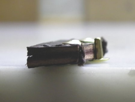

I'm setting them on the dished bar/"anvil" that's in the set. But as you can see from the pictures, the concave areas seem rather deep with sharp edges. . . I figured if I set them on a flat surface, the heads would flatten out, but I don't think my current results are much better. . .
But isn't the rivet post supposed to stick up above the surface a little bit? How much? L'Bum
How do you keep rivet heads from getting flat areas on them (same for snaps, now that I think of it). I have the "Deluxe" Snap-All-Rivet Setter from TLF (made in Taiwan, of course ), but here are some pictures of how the double-cap jiffy rivets from Ohio Travel Bag (purchased through Siegel of California) turn out. . . It looks to me as though the stem is not forming properly in the rivet head -- even though the rivet is the correct length for the leather (I think). Also, I'm pretty sure the anvil and setting tool are leaving marks on the leather around the rivet. . . So I'm wondering what tools/methods everyone else uses to properly set rivets -- in this case, double-capped jiffy rivets -- because mine are not turning out correctly. . . L'Bum
