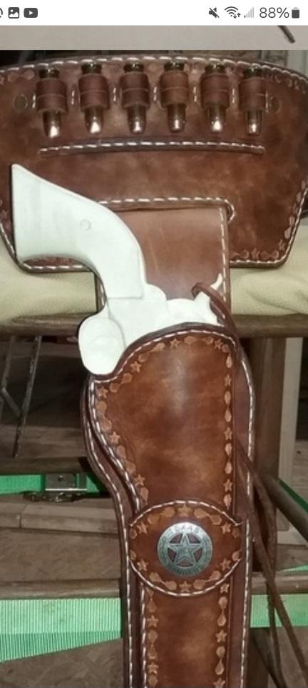

  1. You can also add a thin strip below the ammo loops. And even if loops do loosen up a bit over the years they still want fall out from the bottom. You can also adjust where you put the stop strip to get the rounds to set a little higher in the loops making them easier to fetch. I also like to remove my dummy rounds when loops are allmost dry but not quite. Then they draw up a bit more without the ammo in place. Then work the rounds back in the loops once fully dry for a snug fit that's still usable. Here's a pic of a rig I done using the strip under the ammo loops like a stop. This method works good for straight cartridgeslike the 45acp
