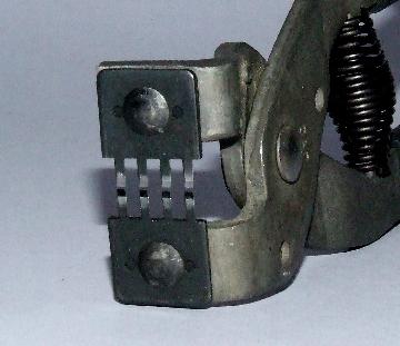

2. if you punch all three pieces separately, use small nails or brads to align the pieces for glue up, usually one in the top hole, a couple along the middle, then the last hole at the bottom of the sheath.
Remember if you use stitching chisels to be sure and punch from the same side when folded as in the front is punched from the front side or outside of the sheath and the back of the sheath is punched from the inside of the sheath, or the angled slots will be reversed and won't line up they will make an x shaped hole. i also use a round awl for the top and bottom holes to help with a nice alignment and clean finished look, always starting my chisels from the same end of the piece, top or bottom.
Another thing that makes your stitching wonky is crossing your stitches as you sew, always one needle, either the left or right, depending on the slot angles, goes in the front. I sew toward myself, so i place the left needle in the slot farthest from me and the right needle closest to me.

Chuck nailed it, as usual.  My biggest issue with hand stitching has been when I don't hold the stitching chisel exactly straight up and down. The side I punch from will be a nice straight line and the other side will wander the opposite of whatever way I leaned the stitching chisel.

just my opinion, but you won't get as nice-looking stitches with round holes due to the angle of the chisel or awl slots makes for the appearance that folks are used to seeing. Plus, the slots will seal back up and hold the stitch tighter, drilling holes loses some leather in the process, whereas slots don't.
To make sewing easier, as you pass the needle through the slot, wiggle it/them up, down, and sideways rather hard to enlarge the slot, making it a simple process to pull through, it will shrink back down, then lightly set the stitch with a hammer when you are done sewing.
