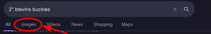

Another tip on searches. Most search engines have tabs under the search field. The first one is usually "All" this is the default tab, the second is usually "Images". Click on that an it'll show you the image search.
