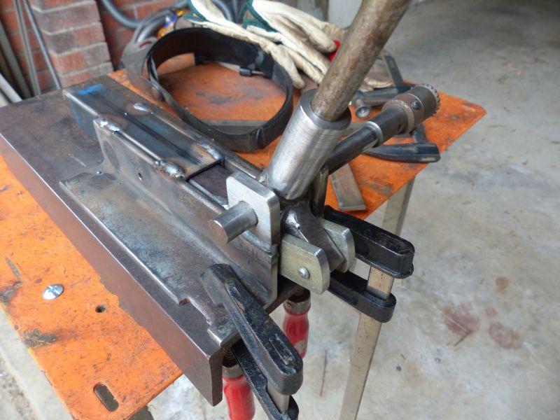

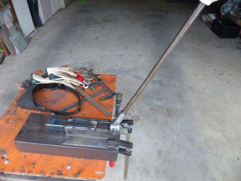

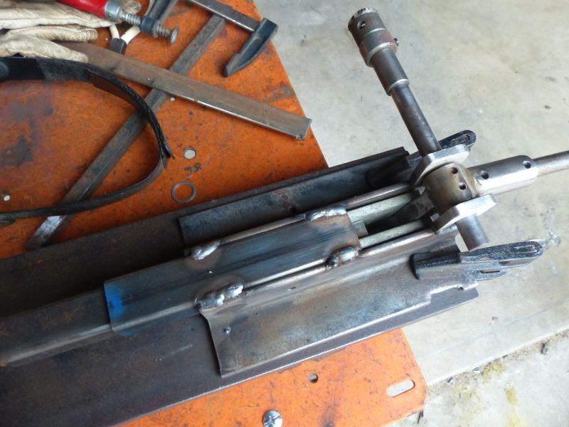

Progress! Much cutting, grinding and welding later and I have something that just might work. The handle is a bit long but it gives plenty of leverage and the linkage works better than I expected. The potential down-side to pushing down on the handle is the force may cause the front to lift, we'll see. It needs a bit of fine-tuning with the grinder and the next thing is to make some bending tools to actually try it on the banding steel.
