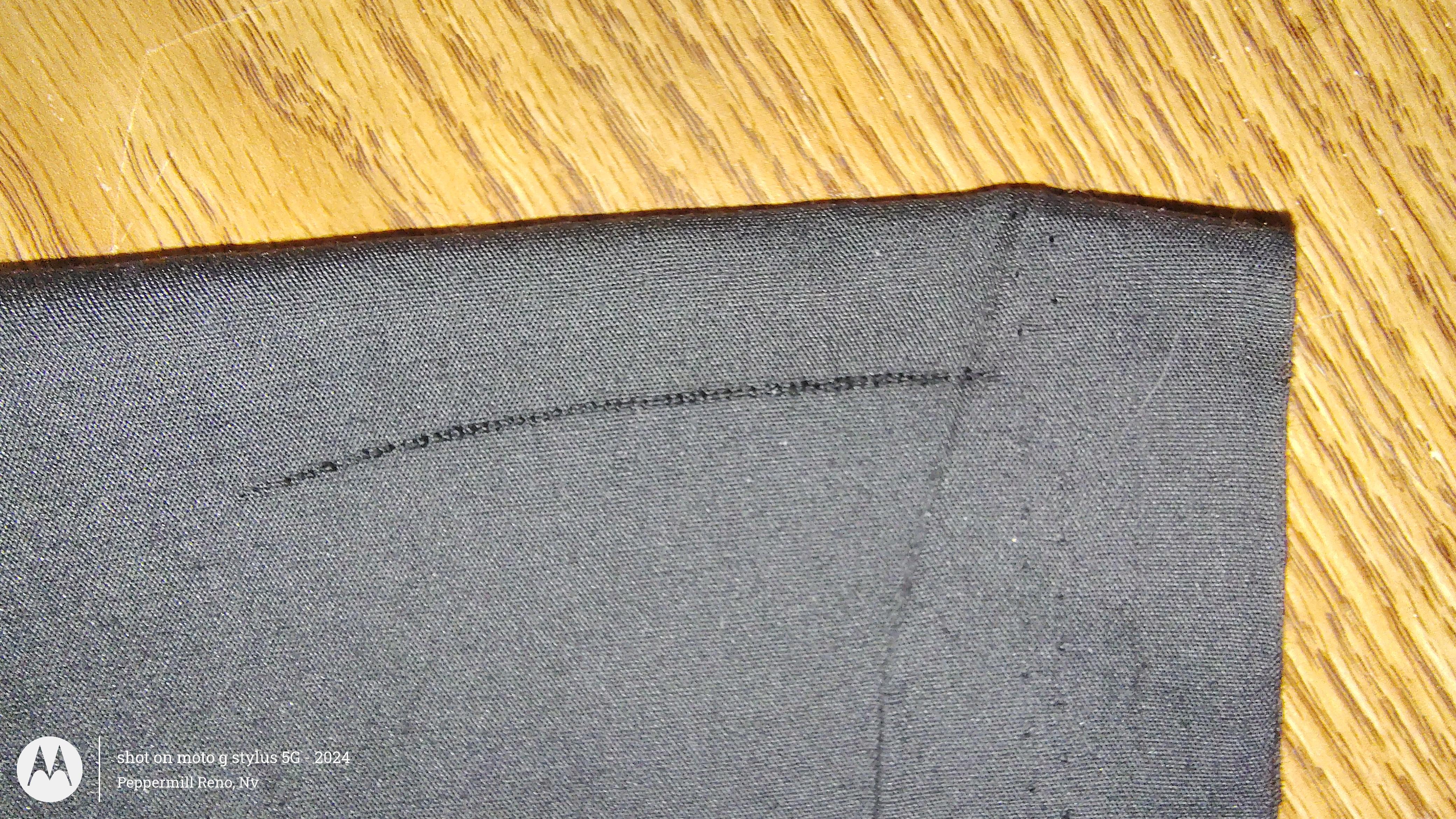

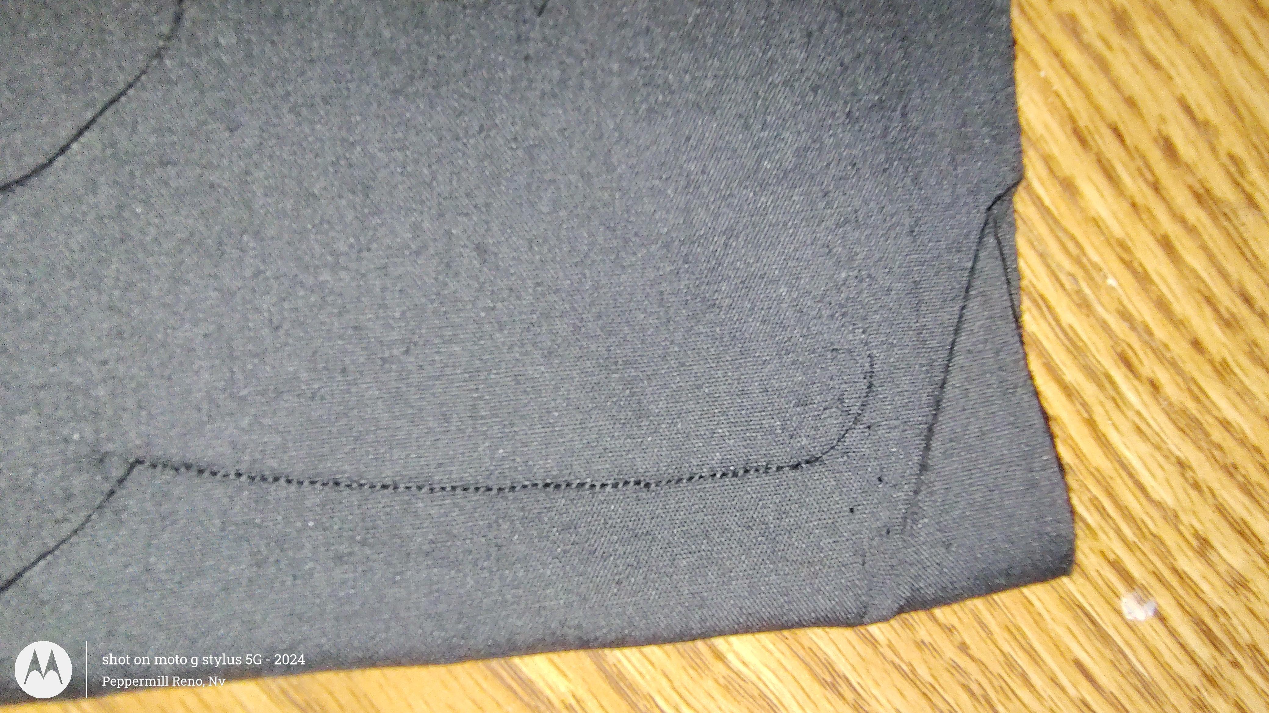

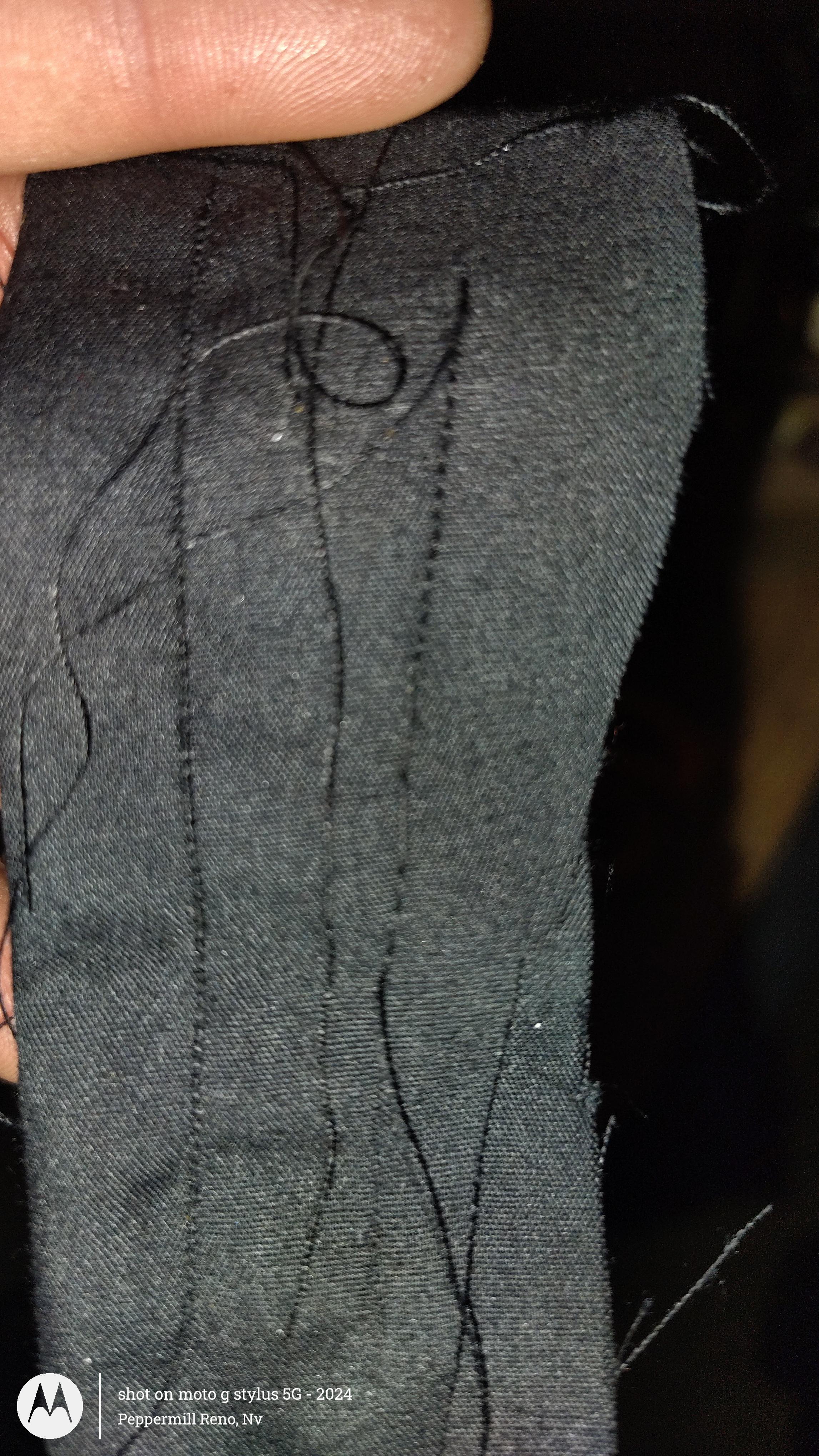

Sorry for the delayed response... My needle is a brand new 135x17 size 20 69# Nylon thread for bobbin and top Material is 1/16" thick. So, 3/16 for the two pieces and a top stitch. The first two photos are of five pieces of material sewn at once 5/16" with no skipped stitches. Top and bottom The third and fourth photo is of a top stitch with only missing once. Top and bottom The fifth photo is of an example of tons of missed stitches with the same setup.
