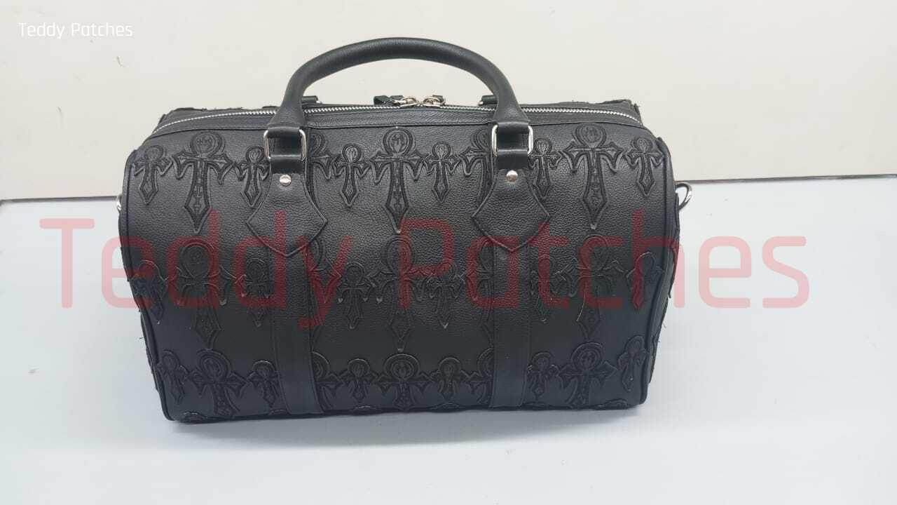

I previously shared an image of the patch, and this is the full look of the bag. How does it look to you?
