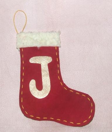

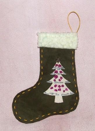

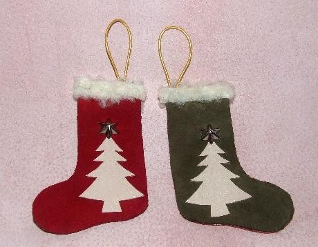

Christmas trees & stockings to hang on a tree or somewhere. Personalized with peoples initials on the other side I made a bunch of these a couple of years ago. Maybe about 20 The year before I made Christmas trees. About 4 to 6 inches tall. Again, made about 20 I don't seem to have photos of the trees, or I can't find them On a couple of the stockings I left the top unsewn and put some sweets (candy) in I used red & green chrome tan (and scraps of faux fleece) but brown or other colours will work just as well HTH

I failed at making one of those months back. I think I used a too-heavy veg tan scrap. I think I'll try again with the chrome tan stuff. Thanks! -

I haven't used a lot of Chrome Tan either. With Christmas coming up, though, you could make some giveaway stuff. Some ideas may be key chains, earrings, found these on the net they would be cool I used 3d leather animals for a search. Oh, and maybe some basic, easy card holders for credit cards. -
