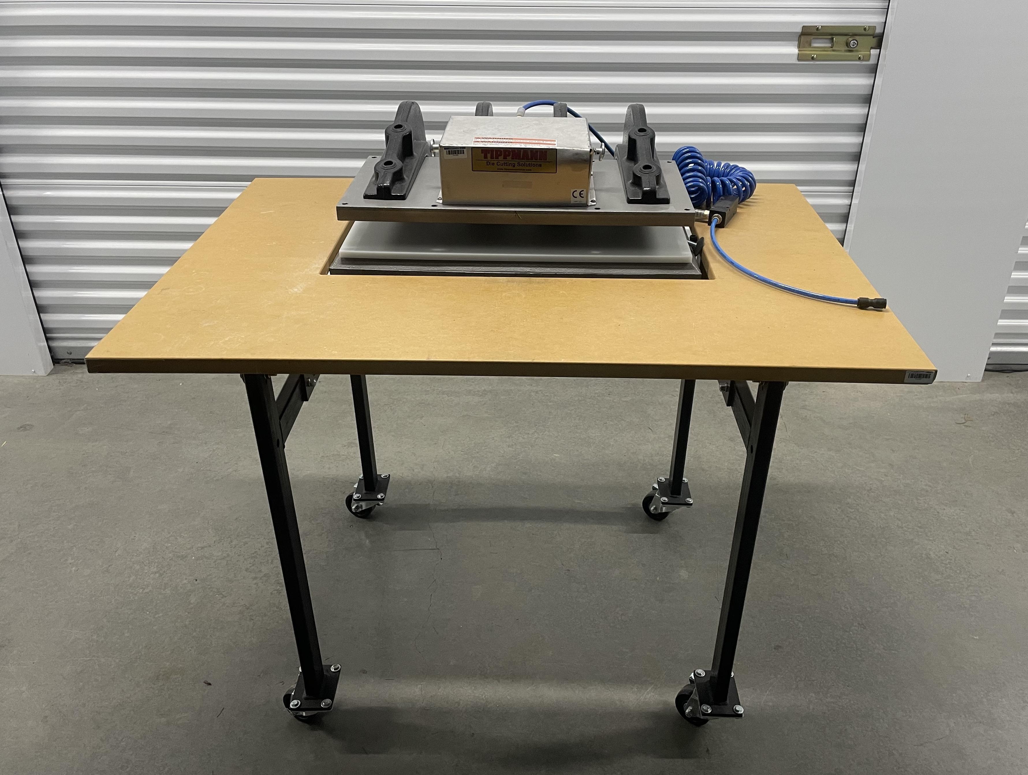

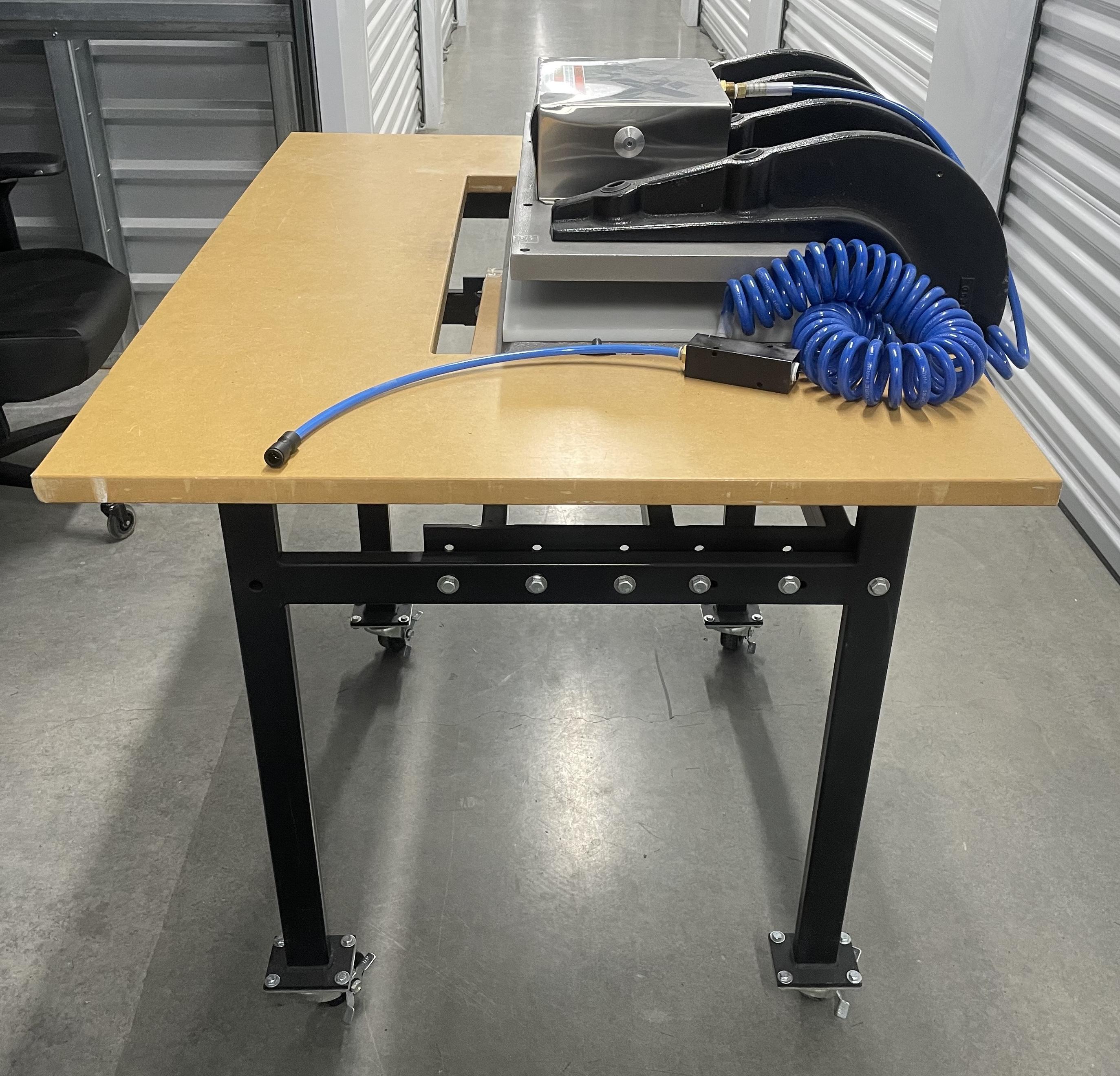

  11. This item has been sold

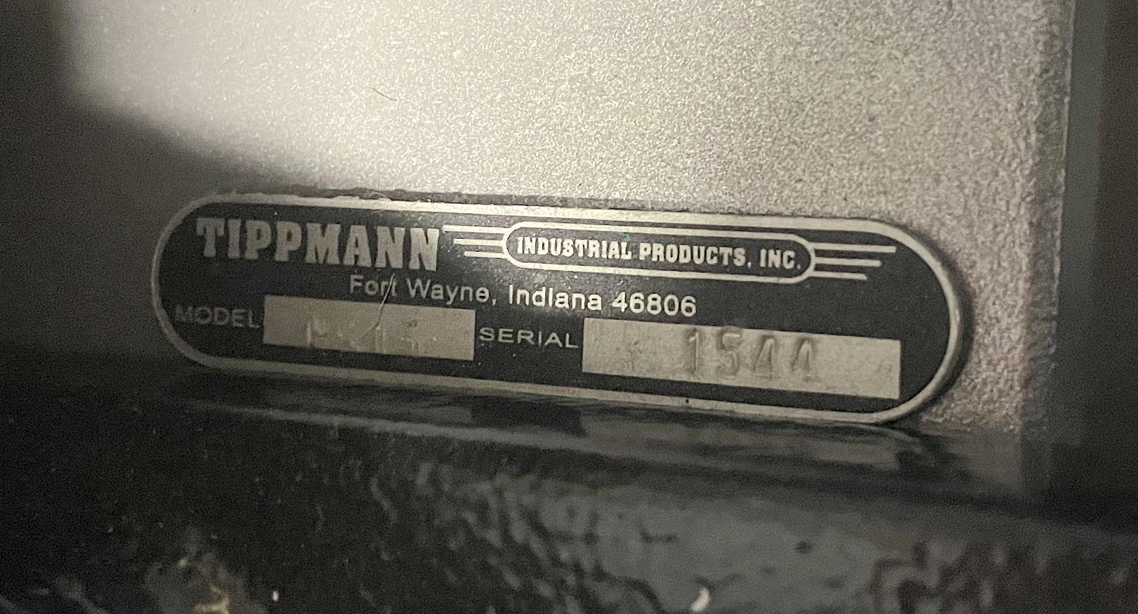

  22. Hello all! Please help me find an operator's manual/ instructions for this machine. Thanks in advance.
