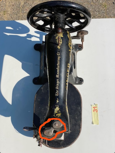

...actually, only precice Singer source says "alternating presser" ,not "walking foot" so, same as my Singer 15-39, differences are: - 15-39 is the backside foot the pulling one, jumping after pull forward, while 78-3 front foot is pulling in a circle move. - 15-39 has feed dog (single line, as also for leather), no needle feed (see pic) Now here is the question (or are the questions): What exactly is the difference of walking foot and alternating presser? I have here two "Singer walking foot attachments", having an inner and an outer foot. But I am not shure about that. My Singer 29 (long freearm shoemaker) has, what I would call a walking foot, (pulling after stitch back, when needle entered cloth/leather, it's going up and in ordinary position) Also Singer 16 KSV 11 has a single foot, but some do not call it walking foot. ----------------------------------------------------------------- Does anybody have a picture of Singer 78-3 (maybe also other do it) from backside? My machine has close to presser lever a loose plate with 2 holes at upper end. Ok, machine lies flat on ground, I forgot to rotate the image to normal stand

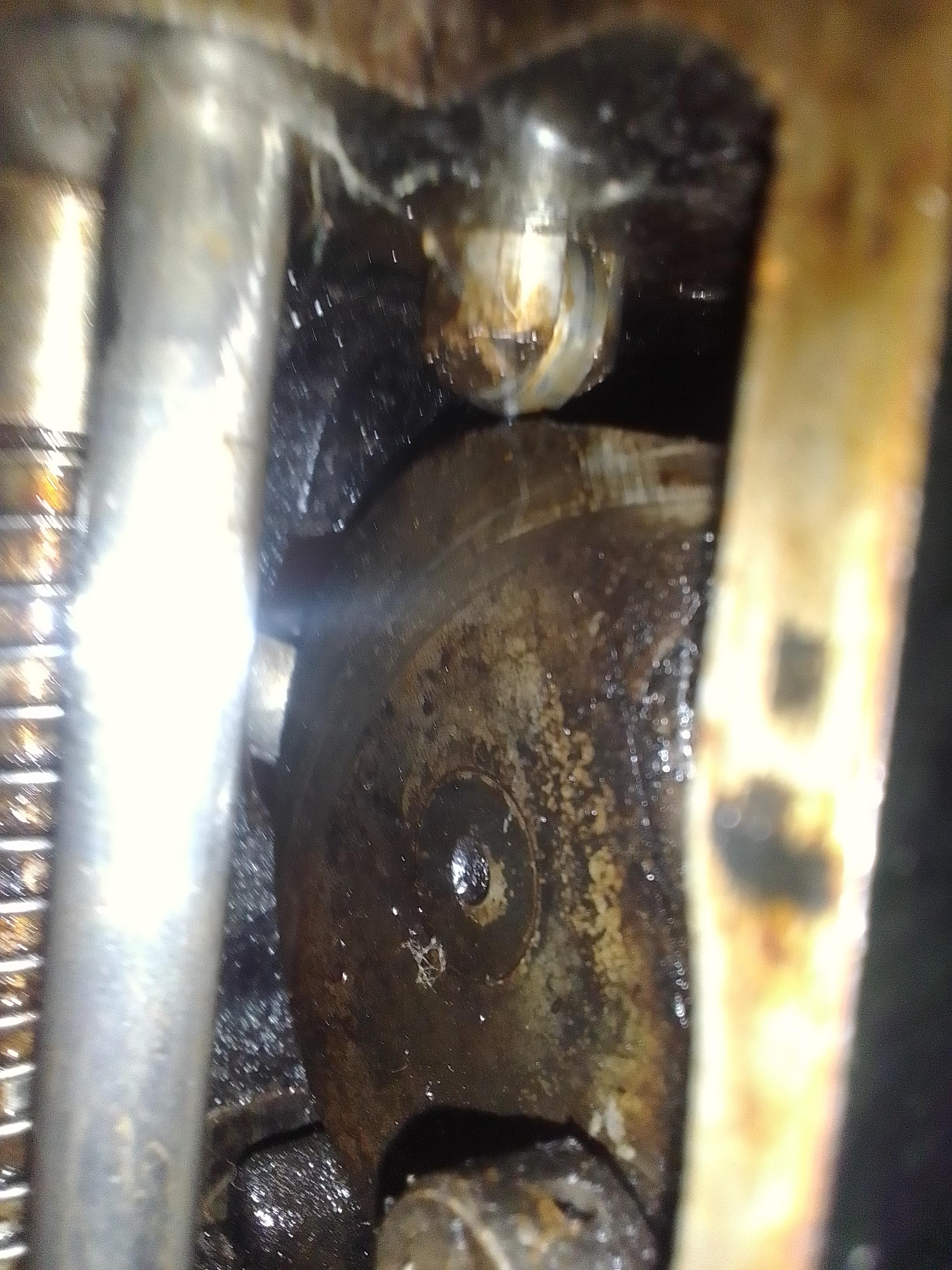

Do you mean the hand wheel just spins and the rest of the machine stops? Maybe a safety clutch problem or the hand wheel is loose on the arm shaft? If the belt is slipping, the solution is obvious ... Can you turn it through by hand when it stops?

When I put a piece of leather in the machine it will punch the holes perfectly. When I thread the machine up the needle stops at the top of the material and won't go through to start stitching. The fly wheel just spins. What adjustments do I need to do to correct this? The machine is well oiled and free from all thread and dirt..a very clean machine. Thanks

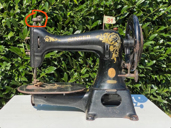

actually, it's not for leather, it's for sacks. And so, it has no feed dogs or such. I wonder, if anybody has informations on it. Or pictures /ideas to build transportation (stitching plate and feed dog are available on ebay, other parts not. But I could also think about something like on Singer 29) The other special about: it lifts the foot between stitches (shure, very useful, when repairing bags), maybe I can use it for fat embroidery😁
