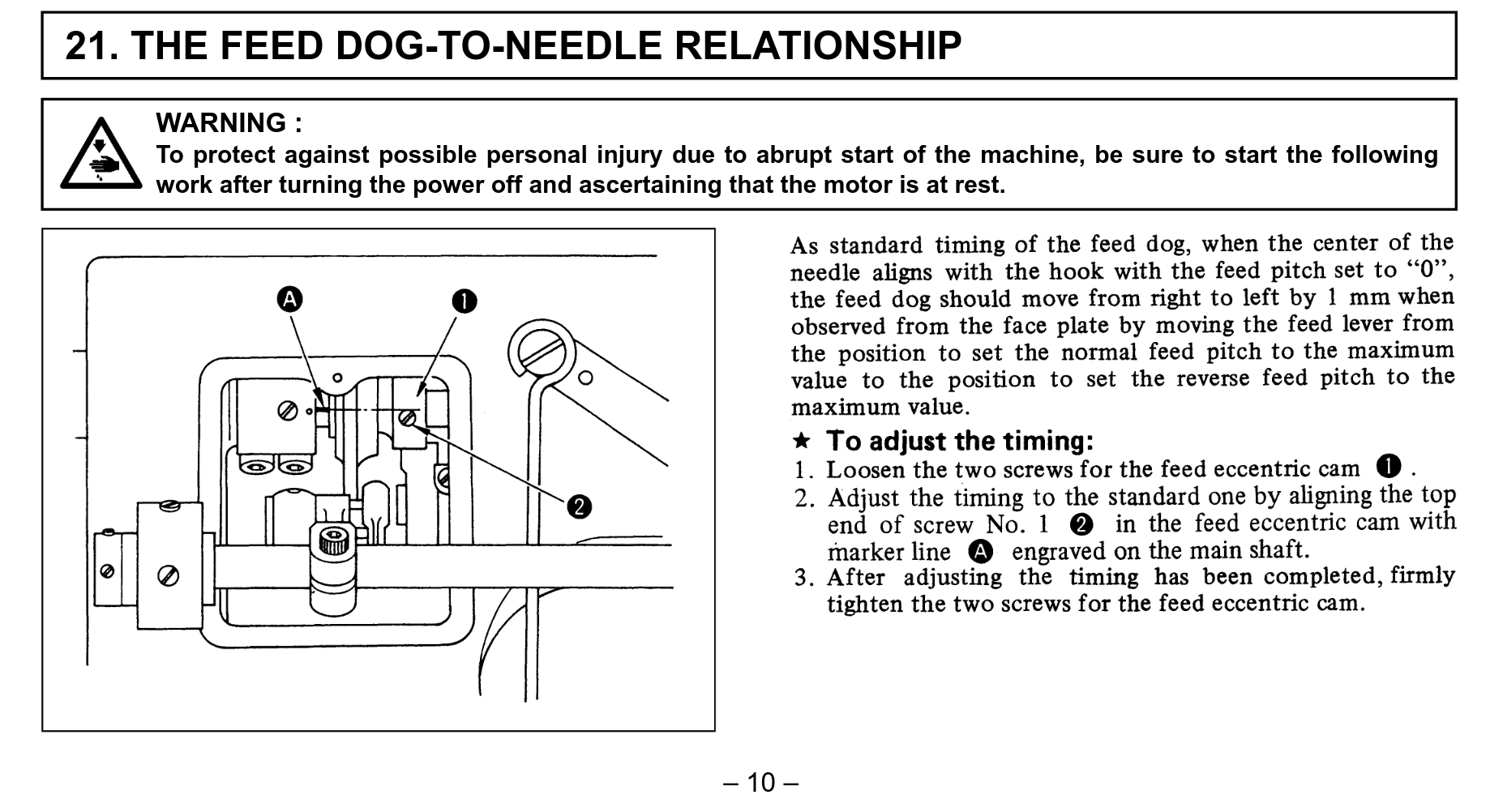

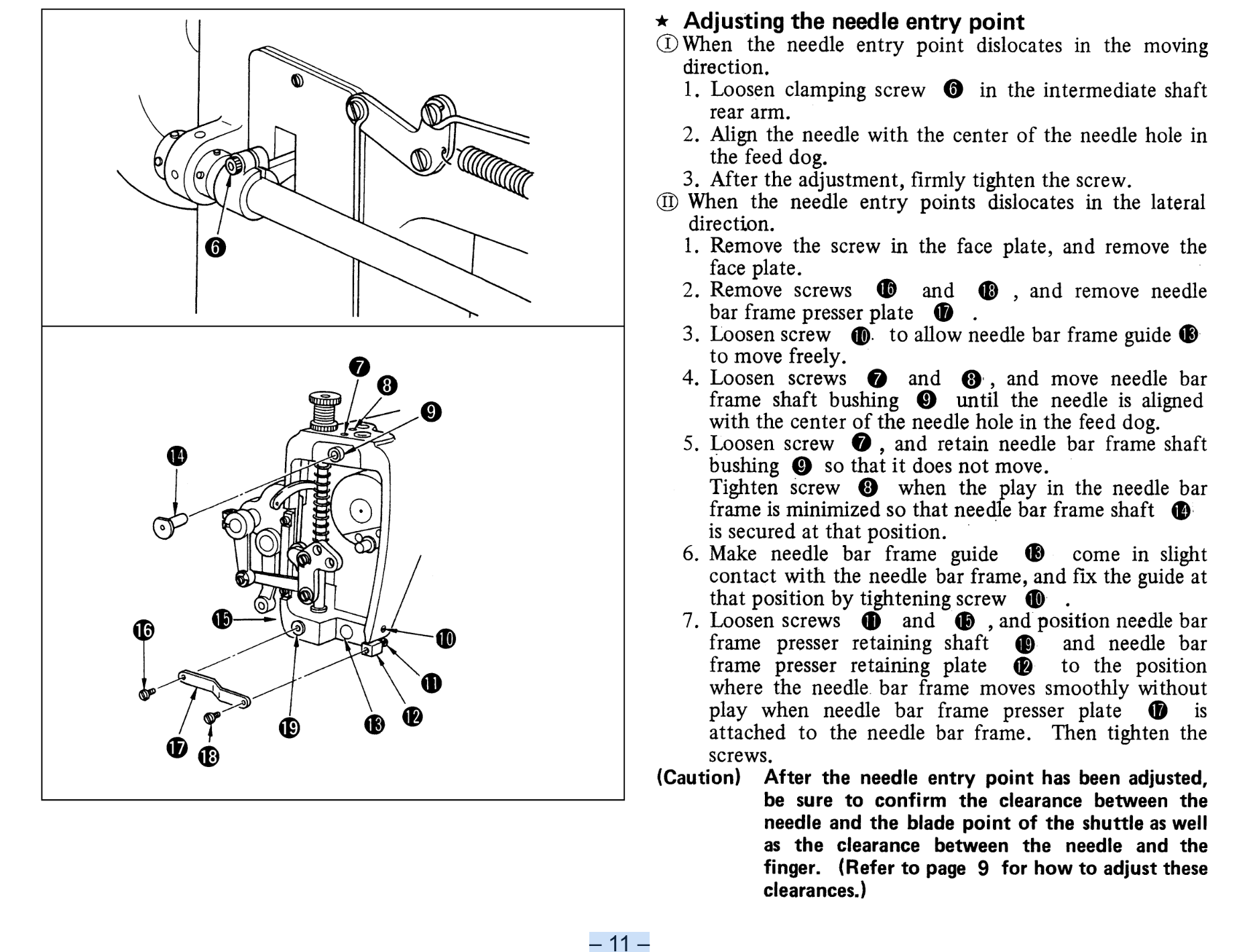

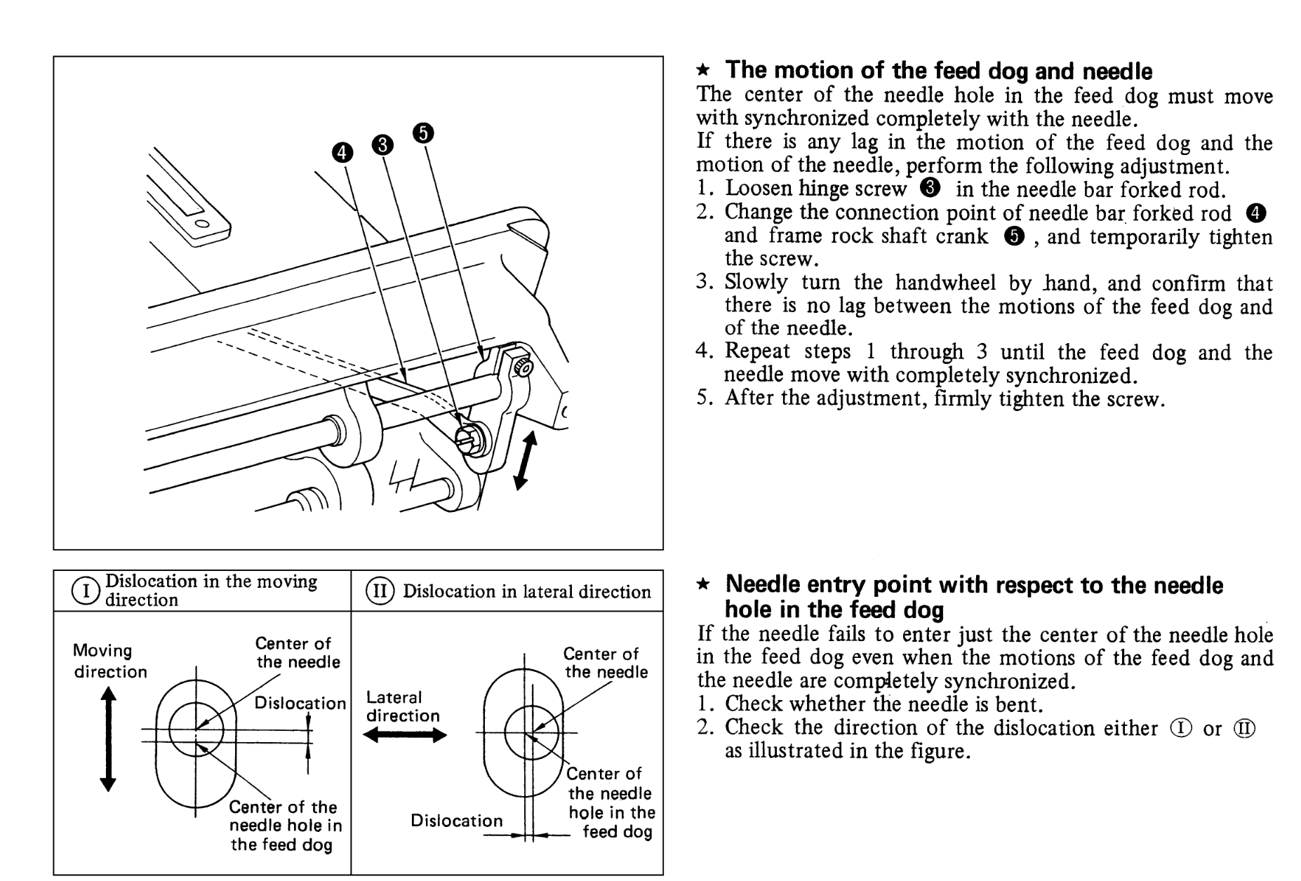

  2. Here a link to a manual for a Juki 243: https://www.manualslib.com/manual/1638502/Juki-Tnu-243.html Section 21 (pages 10 and 11) discusses adjusting the feed dog to needle relationship.
  3. On my machine (Pfaff) you set the needle into the centre of needle hole in the feed dog by moving the needle bar frame. This is the upper assembly that includes needle bar and upper feed mechanism. By my machines is always annoying to get some movements. How is this solved by Juki I rerally don't know. check on which axe the needle bar is hanging, is there and screw that you can loose, and than by rocking the wheel you push the whole assembly slightly to the left.

  7. Yes, that's the point. I need either to move needle bar or feed dog, depending on what is ajustable on this machine to have everything in line I just don't know how to do that. This is why I came here and asked

  21. I can't speak to parts differences, but moving the needle is moving the whole needle. Away from or closer to everything on either side.

  26. Hello CowboyBob, thank you very much for this documentation. The needle to shuttle clearance seems fine, I believe the needle to hit the feed dog, as I can clearly see impact marks on the feed dog and also if you check on picture you can see that needle is too much on the left when going through feed dog hole Also, mine being a flat bed version, so I believe adjustments will involve parts that might differ
