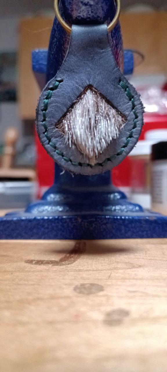

  11. Thanks guys. The stitches are layed out in the die, and the stamp couldn't have been stamped any harder (short of breaking my hardwood stamp). One of the other problems, pointed out by a stranger who didn't see it, is the quality of leather. Bought some cheap from Tandy, to try as liner. It dyes weird, is strange to handle and probably has problems I am unfit to describe well. The 'stranger' was 'Armitage Leather' on youtube. He has a 2h sewing presentation, and early on, he told me something I've known a long time, and keep having to be told. Buy quality. Leather of high quality, he says, works consistently and that limits the errors to the worker, simplifying troubleshooting. This leather, as I said, is the opposite. I think it will be worth going back to Hermann Oaks, or whatever other quality stuff I can find in Canada. It's better, and the errors are more often 'mine'. I will try to make tension consistent, and avoid the backstitch, so thanks for that. I'll be banging out a few of these crappy ones, while meditating on some of these issues. The quality stuff will be after I've got a better result, as I do still have some HO scraps around somewhere. As a side note, it seems to be too slow to include sealhide in this fashion. Also, the hairs look too long for this size of project, I think. Anyhow, onward and thank you guys.

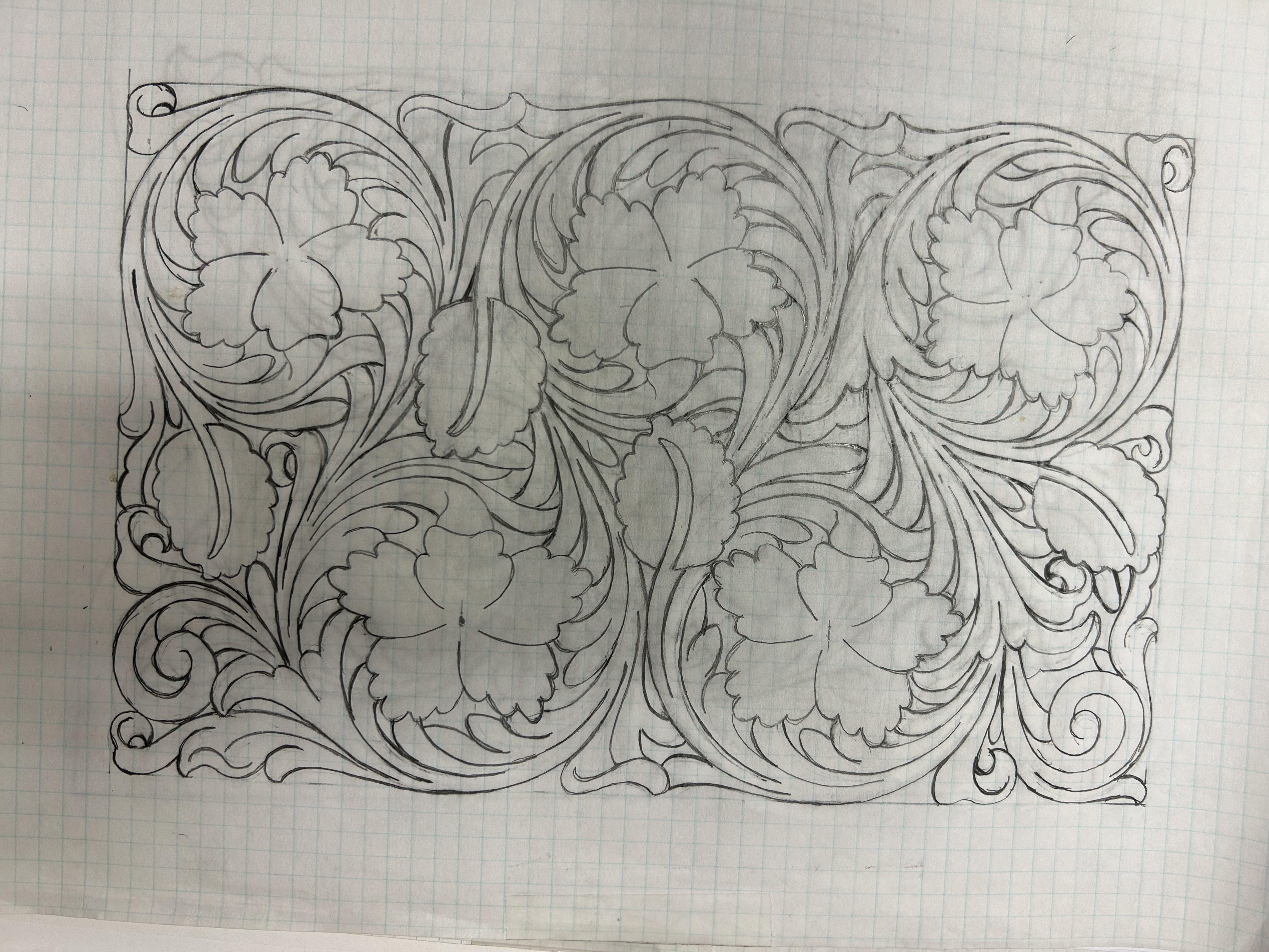

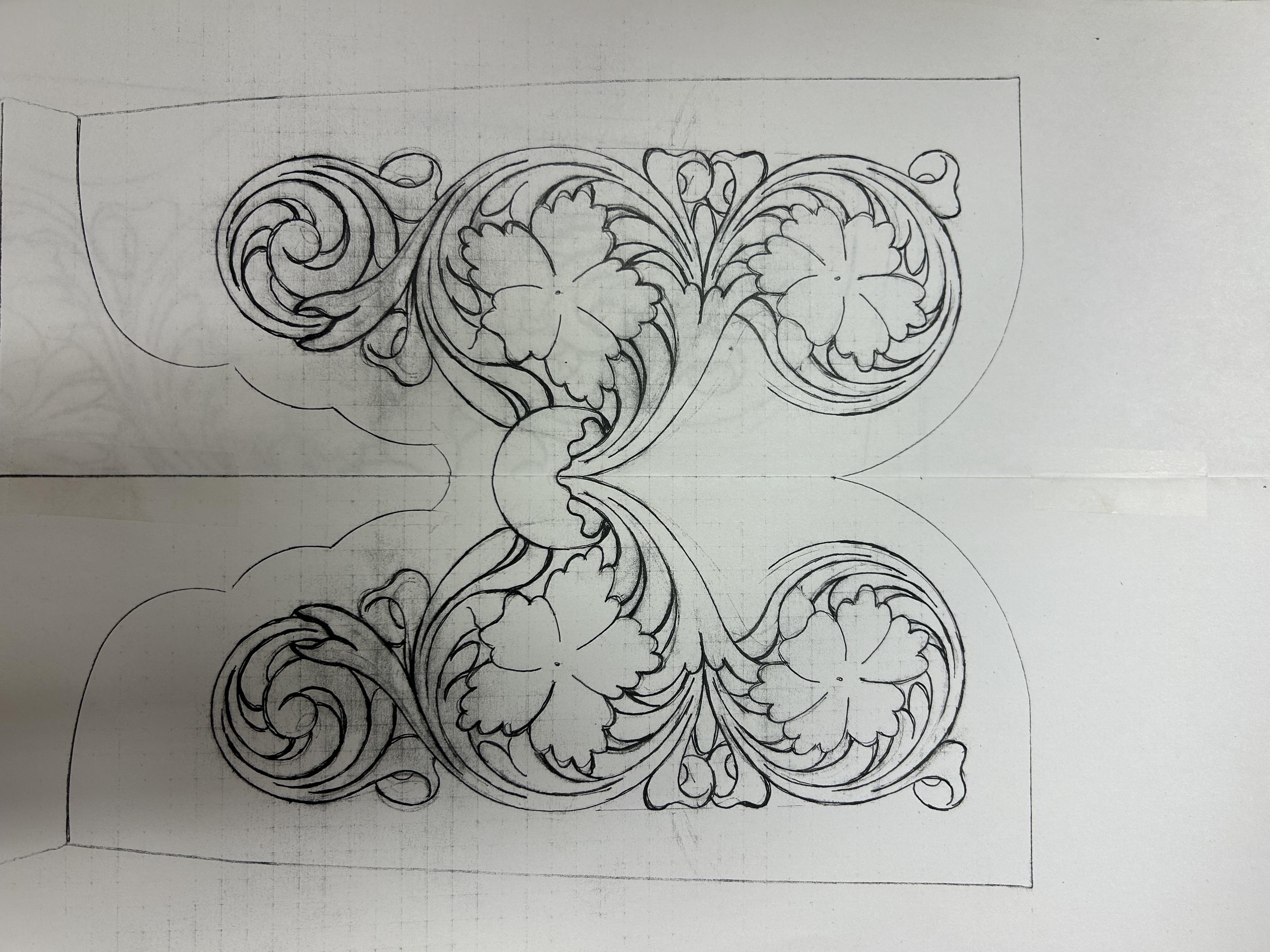

  13. Staggering the circles definitely helps. Make them as big as possible to limit the fill.

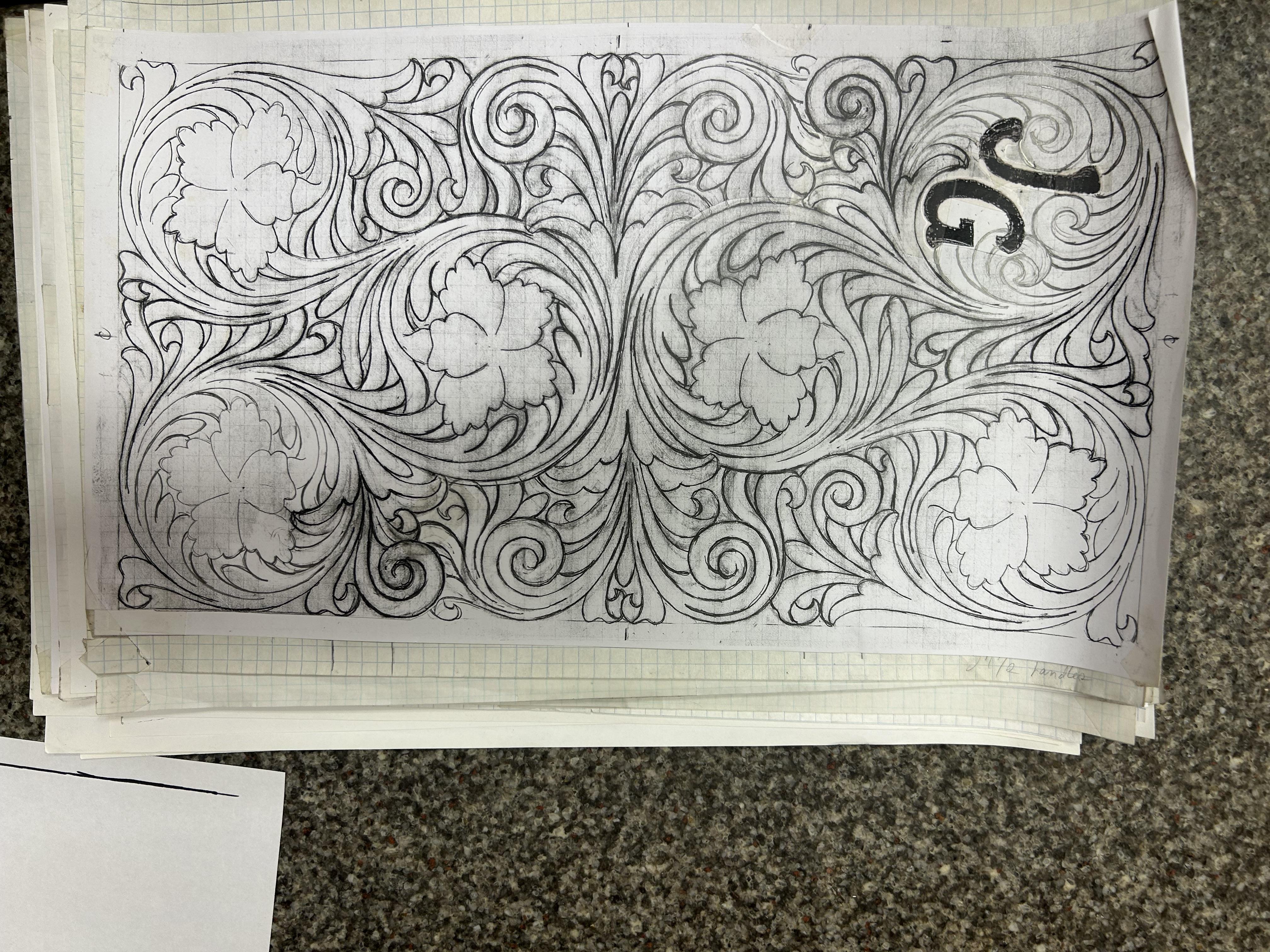

  17. I haven't done a lot of Sheridan style, but I did read the book, lol. Found it on ebay about 6 months back. The book says start with your circles and lay them out, then add the flowers inside, they take up most of the circle. then add the leaves and stumps and such using the circles as reference for your flow of the pattern. What I see in the book is very little negative space between the circles. Sheridan is a very busy looking type of pattern with everything close, touching and overlapping. So you need to enlarge your circles and flowers to fill up that negative space, then your problem will disappear. If it were me, I would make my flowers larger, relocate them so they fill the area a bit more randomly, they are three rows all in a straight line so kind of boring layout. Cut some circles out of paper and use them to lay out your pattern first, move them around to get a good, interesting pattern, then go for the flowers, and then lay in your leaves and such. Hope that helps a bit.

  20. A little harder on the stamp, and maybe just a tension problem with your stitches. Try and pull the same tension with each stitch just as a machine does. But it will be fine when finished, only you can spot the problems.
