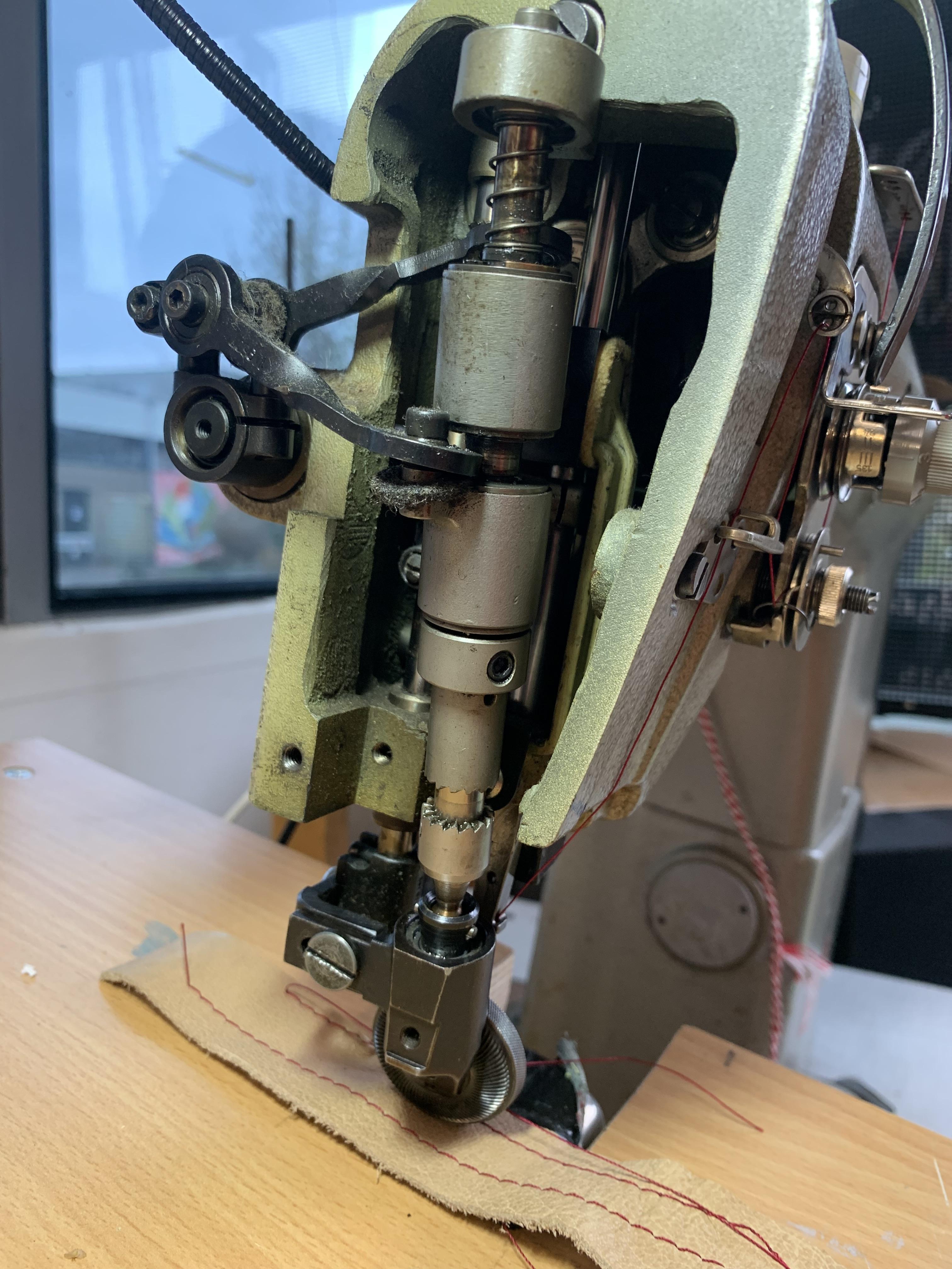

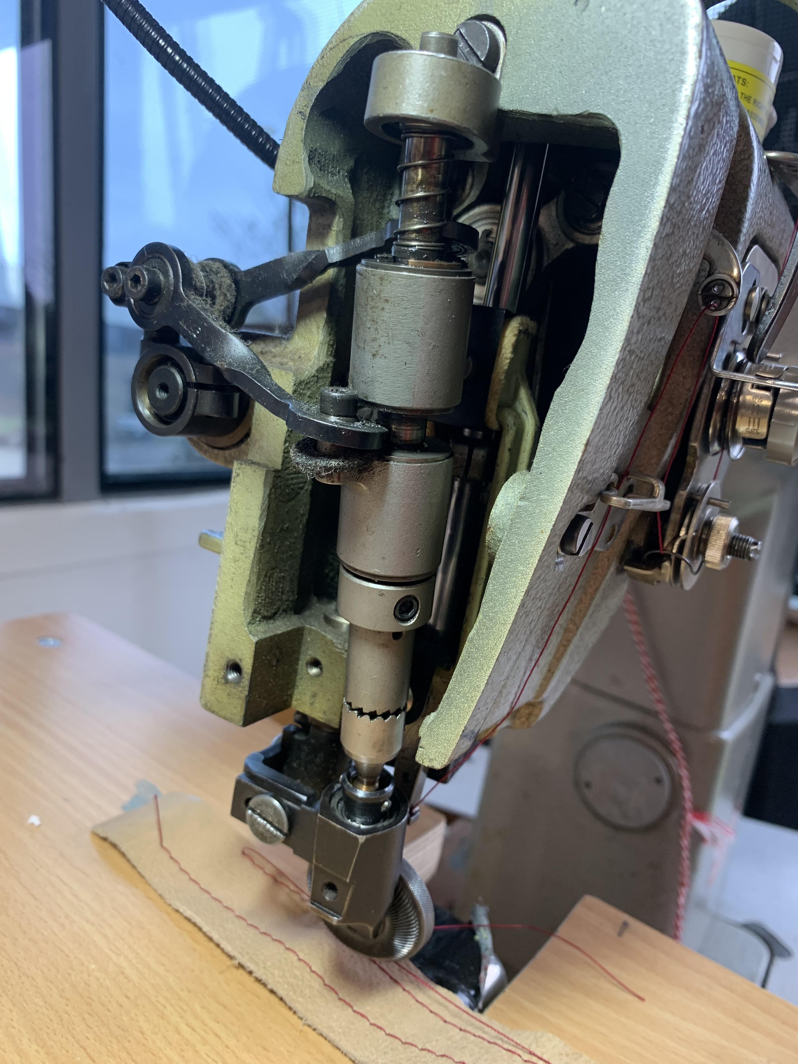

I have the idea that the upper part with the teeth down should be locked in the lower part with the teeth up when the wheel is down on the table. Now it is not driven i guess.
