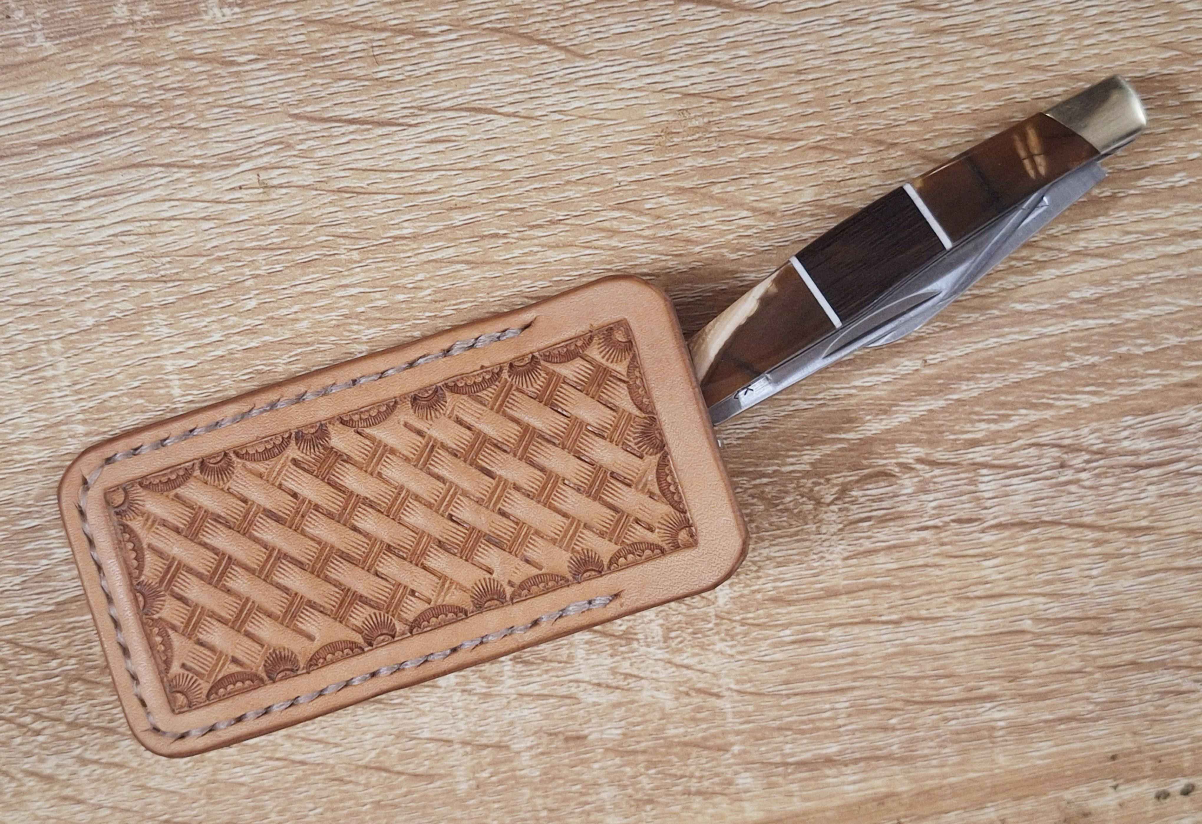

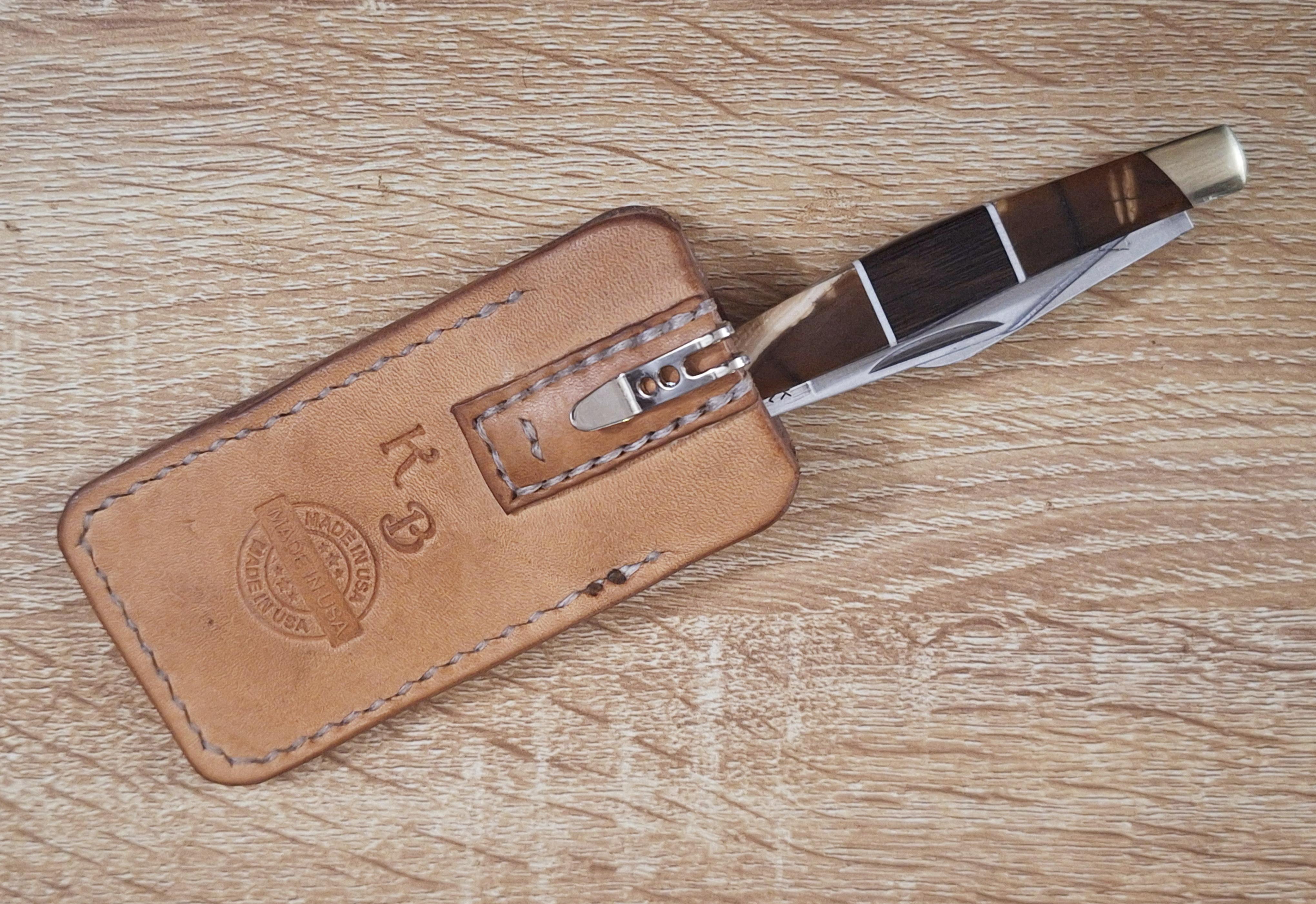

Did that yesterday. Made a pocket sleeve for a Buck 301 size knife, a Case 6375 will fit with 1/8 inch exposed. A clip was added to keep the knife in a vertical positio in your front pocket.
