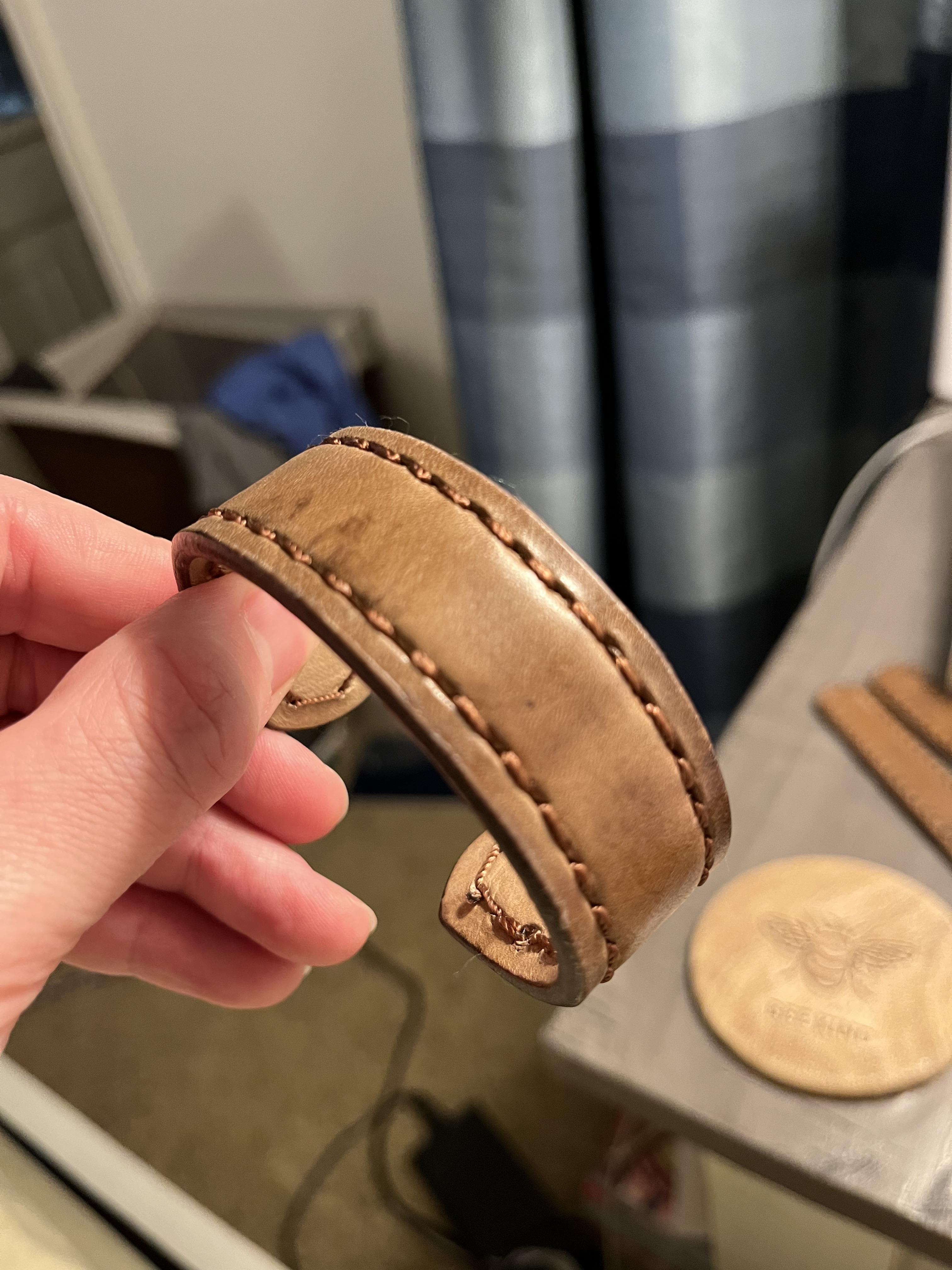

Hello! Previously I'd only hand-stitched stuff with waxed thread but decided to try bonded nylon. I like how this project turned out aesthetically, but I have two questions. 1) How do I keep the thread tight? I stitched the bracelet but when I bent it (copper core), the bottom thread appeared loose. Do I just need to try to sew with a lot more tension? Thicker thread, smaller stitch holes? (The thread I used is 277.) 2) Any suggestions for keeping the thread knot from unraveling from the needle? Because the thread is so slippery, it doesn't hold a knot very well, and I constantly have to re-tighten the knot.
